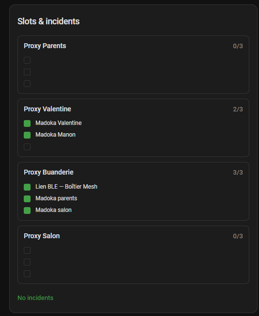

Home Assistant shows you which devices a Bluetooth proxy can hear, but not which ones are holding its GATT connection slots. An ESP32 proxy has only three by default. When one gets stuck on a dead device, your other Bluetooth entities go unavailable with no error — you restart the proxy at random and it happens again.
BlueSight reads the slot data Home Assistant already tracks internally and turns it into diagnostics: deadlock (a device connected to two proxies at once — core issue #176516), ghost slot, pairing storm, missing pairing key, plus proxy offline/stalled/reboot-storm detection. Everything shows up as sensors plus a notification naming the fix, not just an error code. An optional ESPHome component upgrades the heuristics to measured evidence — details in the README.

Update: the Lovelace card is now included — added it back in v0.4.0, my mistake for saying otherwise earlier. Just install/upgrade through HACS and it’ll be there.

Also since the original post: the Lovelace card ships with the integration and registers its own dashboard resource (0.4.0 — the manual steps described above are gone), the card names the device holding each slot, and the interface and notifications follow your language, English and French.

Two releases since the last post here. The card now supports the layout: tile option (the whole fleet on one line, a coloured dot, tap to open the full card). A full code review fixed four bugs, including one that double-counted failed pairings on proxies running the ESPHome component. 0.9.0 adds an event when each incident opens and resolves, a repair that retires a proxy offline for an hour with one click, the connection path (which proxy hears the device best, and why not another), and translated entity names (your entity ids do not change). Details: Release v0.9.0 — acting on what BlueSight finds, and knowing why that proxy · dasimon135/ha-bluesight · GitHub
Where do I find the card?
I use yaml only for dashboards.
EDIT:
Never mind. I found it but I can’t get it to work.
I tried adding to resources using your example yaml but that didn’t work.
So I moved the card js file to my usual resources location in www and added it to the resources that way (like every other custom card I use).
trying it both ways when I add the basic minimal yaml to my dashboard I get “configuration.error”
EDIT2:
and again never mind. I had to clear the cache. It seems to be working now.
