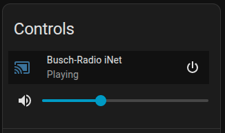

The radio shows up as a media player. Turn it on/off, set volume, pick a station, configure settings (yes!)
