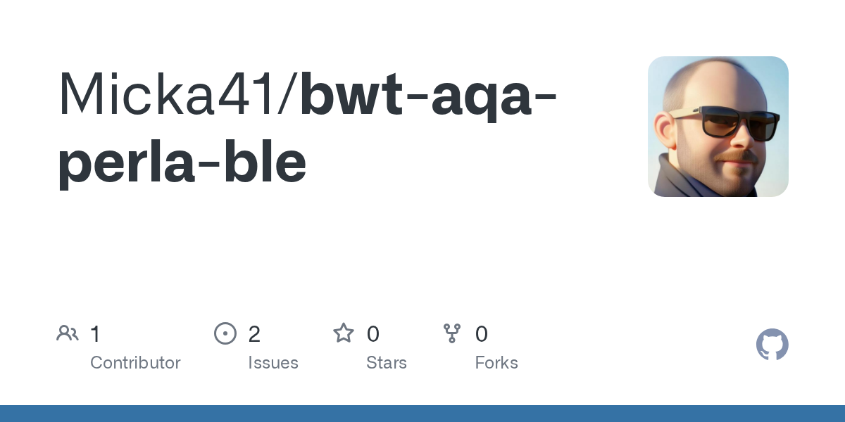

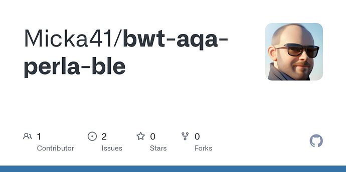

Add via HACS (custom repository) or copy the custom_components/bwt_aqa_perla_ble folder to your HA config directory.
GitHub: https://github.com/Micka41/bwt_aqa_perla_ble
Feedback welcome — especially from users with different BWT models or firmware versions.
Hi there, your project seems private as github link is broken
Yes, it’s a mistake :
