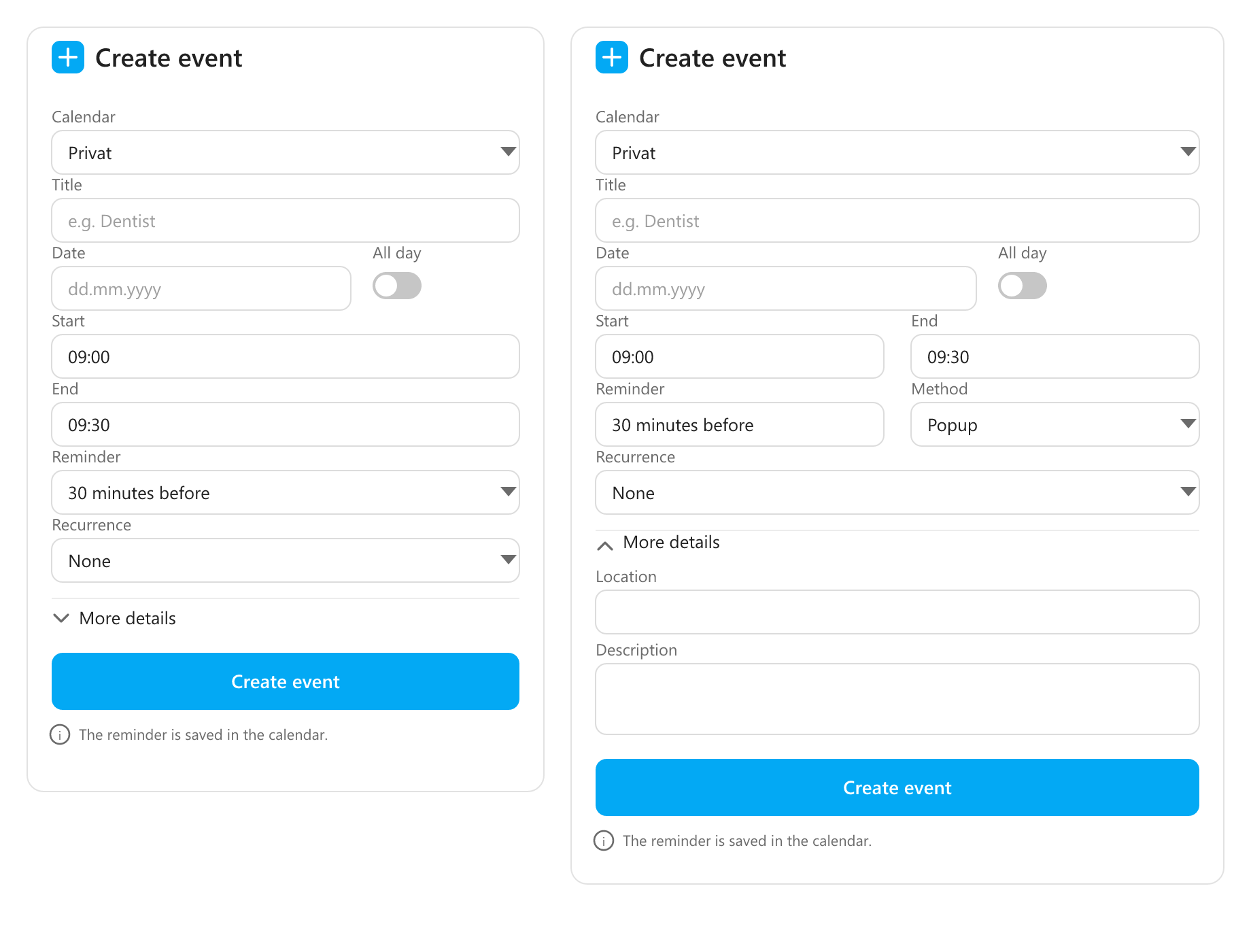

  • Register two Lovelace “Create event” cards for phone and tablet layouts
[Layout preview: phone and tablet cards side by side]
