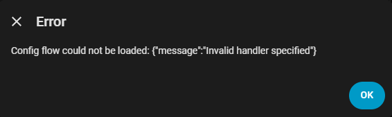

Thanks for the integration; this is exactly what I’m looking for. My HA machine is within 2 meters from the Daikin Madoka, so it should be possible to use the BT adapter on my HA machine to connect with the Madoka. Some ‘noob’ questions:
  • How can I upload the integration to the custom_components/daikin_madoka/? I have downloaded the ZIP file from Github, but how to install it on my HA machine? I have installed integrations via HACS, but never manually.
  • Which add-on is used for the BT pairing process?
Thanks in advance.
Just uploaded to ZIP file to the HA server, unpacked it via Terminal & SSH in custom_components. Also succesfully paired my Madoka via bluetoothctl. But when I want to add the integration via Settings → Integrations → Add → Daikin Madoka, I got this failure:
What I am doing wrong…? Information from log:
Logger: homeassistant.config_entries
Source: config_entries.py:3969
First occurred: 2:43:35 PM (4 occurrences)
Last logged: 3:51:19 PM
Error occurred loading flow for integration daikin_madoka: cannot import name ‘discover’ from ‘bleak’ (/usr/local/lib/python3.13/site-packages/bleak/init.py)
Bei mir kommt der gleiche Fehler: Der Konfigurationsfluss konnte nicht geladen werden: {“message”:“Invalid handler specified”}
Quelle: config_entries.py:3969
Erstmals aufgetreten: 06:01:51 (1 Vorkommnis)
Zuletzt protokolliert: 06:01:51
Logger: homeassistant.util.loop
Quelle: util/loop.py:137
Detected blocking call to import_module with args (‘custom_components.daikin_madoka.config_flow’,) inside the event loop by integration ‘config’ at homeassistant/components/config/config_entries.py, line 195: return await super()._post_impl(request, data) (offender: /usr/src/homeassistant/homeassistant/loader.py, line 1307: return importlib.import_module(f"{self.pkg_path}.{platform_name}")), please create a bug report at GitHub · Where software is built For developers, please see Blocking operations with asyncio | Home Assistant Developer Docs Traceback (most recent call last): File “”, line 198, in _run_module_as_main File “”, line 88, in _run_code File “/usr/src/homeassistant/homeassistant/main.py”, line 229, in sys.exit(main()) File “/usr/src/homeassistant/homeassistant/main.py”, line 215, in main exit_code = runner.run(runtime_conf) File “/usr/src/homeassistant/homeassistant/runner.py”, line 289, in run return loop.run_until_complete(setup_and_run_hass(runtime_config)) File “/usr/local/lib/python3.13/asyncio/base_events.py”, line 712, in run_until_complete self.run_forever() File “/usr/local/lib/python3.13/asyncio/base_events.py”, line 683, in run_forever self._run_once() File “/usr/local/lib/python3.13/asyncio/base_events.py”, line 2050, in _run_once handle._run() File “/usr/local/lib/python3.13/asyncio/events.py”, line 89, in _run self._context.run(self._callback, *self._args) File “/usr/local/lib/python3.13/site-packages/aiohttp/web_protocol.py”, line 510, in _handle_request resp = await request_handler(request) File “/usr/local/lib/python3.13/site-packages/aiohttp/web_app.py”, line 569, in _handle return await handler(request) File “/usr/local/lib/python3.13/site-packages/aiohttp/web_middlewares.py”, line 117, in impl return await handler(request) File “/usr/src/homeassistant/homeassistant/components/http/security_filter.py”, line 92, in security_filter_middleware return await handler(request) File “/usr/src/homeassistant/homeassistant/components/http/forwarded.py”, line 87, in forwarded_middleware return await handler(request) File “/usr/src/homeassistant/homeassistant/components/http/request_context.py”, line 26, in request_context_middleware return await handler(request) File “/usr/src/homeassistant/homeassistant/components/http/ban.py”, line 86, in ban_middleware return await handler(request) File “/usr/src/homeassistant/homeassistant/components/http/auth.py”, line 242, in auth_middleware return await handler(request) File “/usr/src/homeassistant/homeassistant/components/http/headers.py”, line 41, in headers_middleware response = await handler(request) File “/usr/src/homeassistant/homeassistant/helpers/http.py”, line 73, in handle result = await handler(request, **request.match_info) File “/usr/src/homeassistant/homeassistant/components/http/decorators.py”, line 83, in with_admin return await func(self, request, *args, **kwargs) File “/usr/src/homeassistant/homeassistant/components/http/data_validator.py”, line 74, in wrapper return await method(view, request, data, *args, **kwargs) File “/usr/src/homeassistant/homeassistant/components/config/config_entries.py”, line 188, in post return await self._post_impl(request, data) File “/usr/src/homeassistant/homeassistant/components/config/config_entries.py”, line 195, in _post_impl return await super()._post_impl(request, data)

You’re on a build older than v2.3.0. That error — cannot import name 'discover' from 'bleak' — comes from an old pinned version of the pymadoka library that imported discover from bleak, which bleak removed in ≥ 0.20. When the library fails to import, config_flow.py can’t load, which is why Home Assistant reports “Invalid handler specified” and refuses to add/open the integration. (The “Detected blocking call to import_module” traceback is a secondary side-effect of that failed import; it clears on its own once the integration loads cleanly.)
This was fixed in v2.3.0 and improved further in v2.4.0 — please update to v2.4.0 and restart Home Assistant. v2.4.0 connects through Home Assistant’s own Bluetooth stack and uses the pymadoka-ng library from PyPI (installed automatically), so the bleak/discover incompatibility is gone.
How to update:
  • HACS: open the Daikin Madoka integration in HACS → update to the latest release → restart HA. If HACS still offers only the old version, remove and re-add the repository, or use Redownload and pick the latest.
  • Manual: replace custom_components/daikin_madoka/ with the v2.4.0 release contents and restart.
After the update the config flow will load normally. If you still see the discover/bleak error afterwards, it usually means an old cached pymadoka is still installed — a full HA restart (not just a reload) clears it; if it persists, post your logs and I’ll help.
sorry for the late response.
You’re not doing anything wrong in Home Assistant — the ZIP you uploaded is an old version of the integration (pre‑v2.3.0). That build pins an old pymadoka library that imports discover from bleak, which bleak removed in ≥ 0.20. When the library fails to import, config_flow.py can’t load, so “Add integration → Daikin Madoka” fails. Pairing via bluetoothctl is fine and unrelated — the failure is purely the outdated code.
Fix: install v2.4.0 specifically.
  1. Download it from the Releases page of this repo (make sure it’s dasimon135/daikin_madoka, not the original upstream): Release v2.4.0 — Modern Bluetooth: ESPHome proxy support, auto-discovery, self-healing · dasimon135/daikin_madoka · GitHub → Assets → source code (zip). (The green Code → Download ZIP of the main branch also works — both are current.)
  2. Replace the folder custom_components/daikin_madoka/ on your server with the custom_components/daikin_madoka/ from that download (delete the old one first so no stale files remain).
  3. Fully restart Home Assistant (Settings → System → Restart — not just “reload”). On restart, HA installs the new requirement.
Why this works cleanly: v2.4.0 connects through Home Assistant’s own Bluetooth stack and depends on pymadoka-ng from PyPI (a renamed library). Because the dist name is different from the old pymadoka, HA installs it fresh — the broken bleak/discover import is gone. Your existing bluetoothctl pairing stays valid.
After the restart, “Add integration → Daikin Madoka” will load the config flow normally (it will also auto‑discover the thermostat if it’s advertising nearby). If you still get the discover error, an old cached pymadoka is lingering — a full restart clears it; if not, post your logs.
Tip: for automatic future updates, install via HACS as a custom repository (https://github.com/dasimon135/daikin_madoka, category Integration) instead of the manual ZIP.

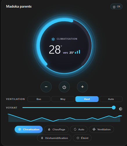

## :rocket: Daikin Madoka (BRC1H) v3.0.0 — a dial card, guided recovery & rock-solid reconnection
Hi everyone,
v3.0.0 of the Daikin BRC1H “Madoka” custom integration is out. After 2.4.0 (“Modern Bluetooth”), this release is all about the dashboard experience and reliability — validated on real hardware.
Repo: GitHub - dasimon135/daikin_madoka: Home Assistant custom component integration for the BRC1H thermostat (madoka) · GitHub

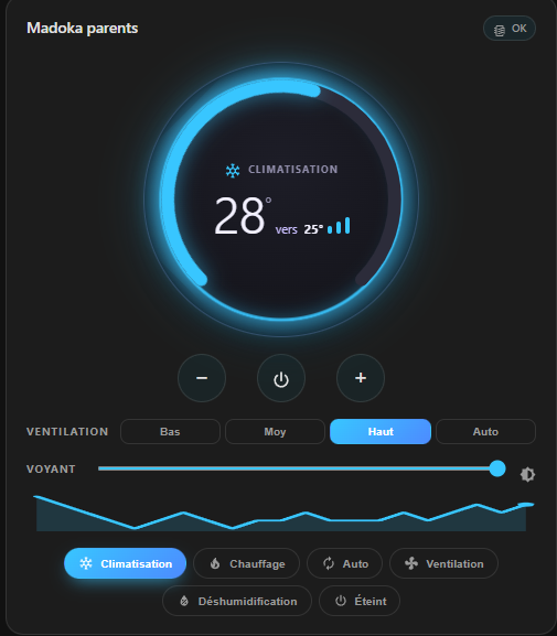

:control_knobs: The Madoka Card
The headline feature: a dial-style Lovelace card shipped inside the integration (auto-registered, no separate install). It mirrors the physical BRC1H — a glowing halo that changes color with the mode, a setpoint arc, fan segments, controls, a mode switcher, an eye-brightness slider, a 12 h temperature sparkline and filter/signal chips.
Three layouts:
type: custom:madoka-cardentity: climate.my_madoka# layout: full | compact | tile
  • full — the complete dial · compact — dial + controls · tile — an ultra-compact row that lines up with HA’s native tile cards
It auto-discovers the related entities (outdoor temp, brightness, filter, signal) from the same device — you only give it the climate.* entity. Follows your theme and language (modes from HA’s own climate translations; card words in en/fr/es/de/it/nl).

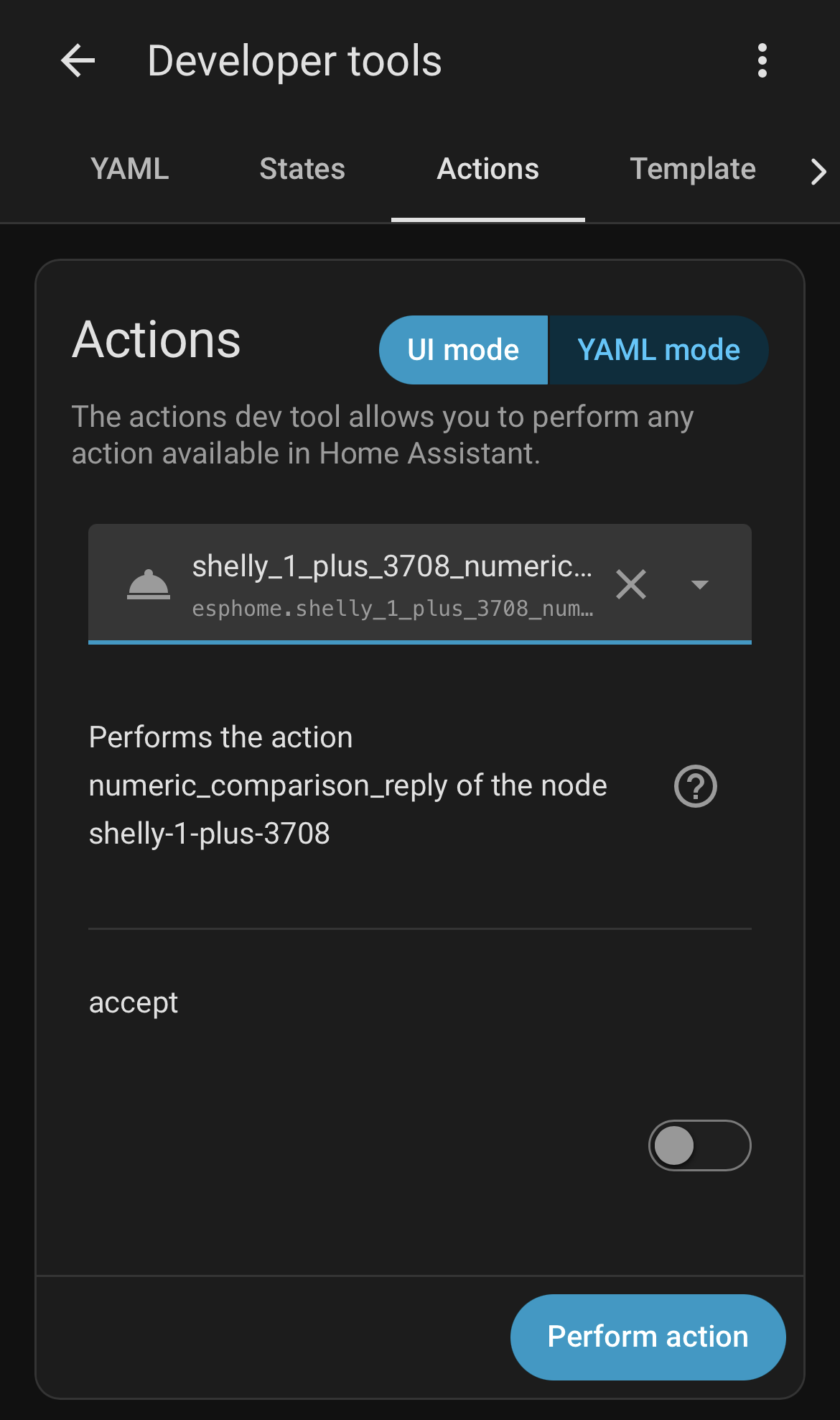

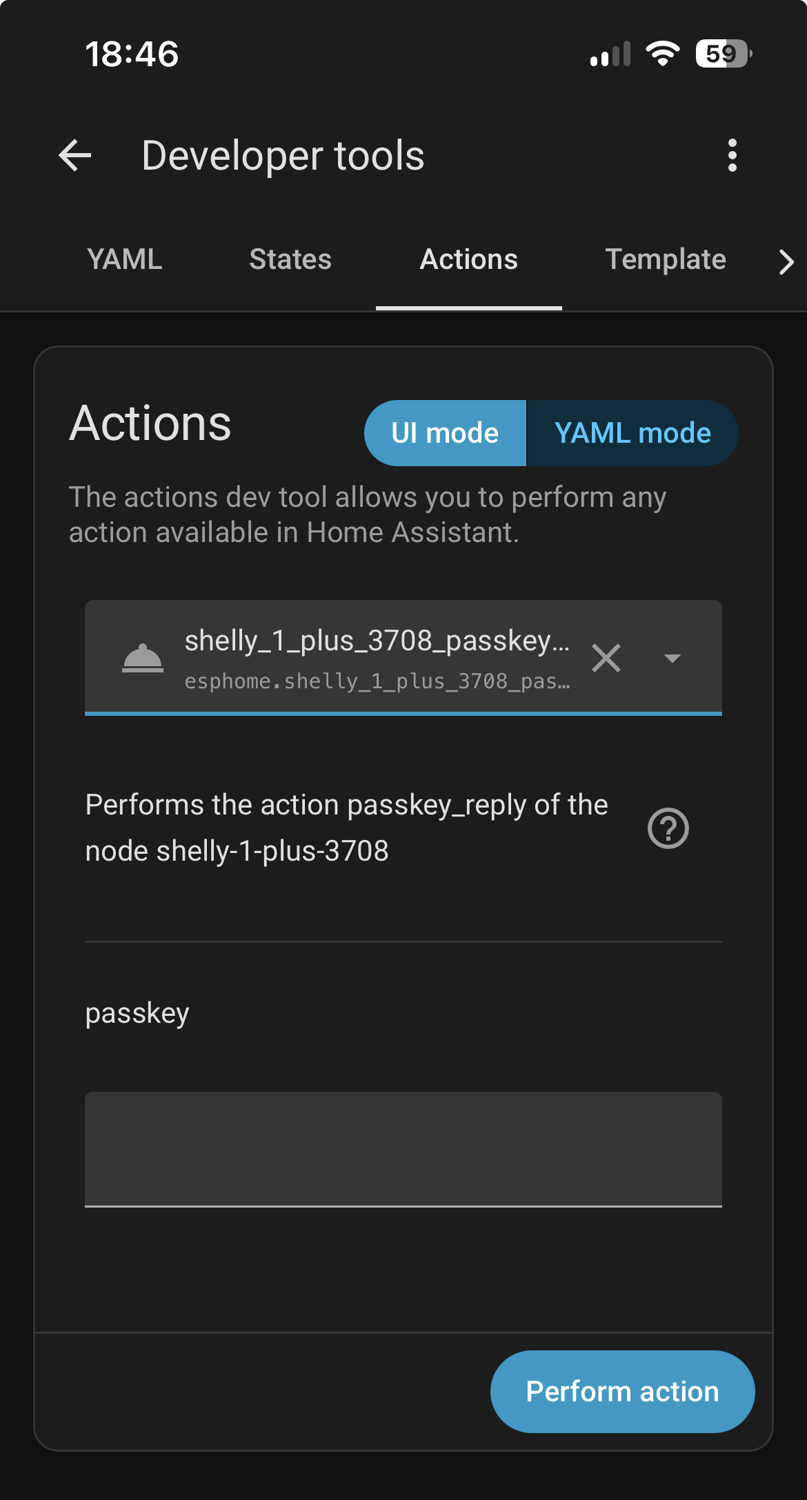

I think you can also manually use the pairing from developer tools:
and
Not sure if it helps here, but I vaguely remember i used it with the 1st dailin AC i ever paired
