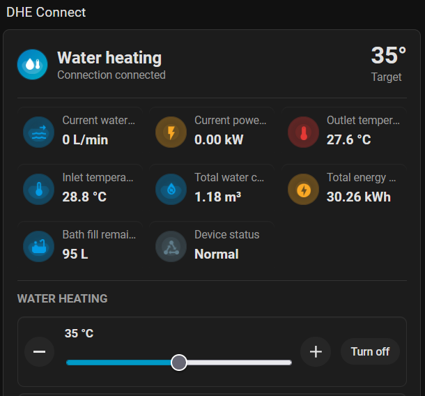

  • Live water flow and current power sensors
  • Total water and energy consumption sensors
  • Eco mode, bath fill, child safety and temperature memory controls
  • Shower, toothbrush and wellness timer controls
  • Radio media player with metadata, volume and favorites
  • Weather entity and weather favorite handling
  • Diagnostic entities for connection, reconnects and device state
