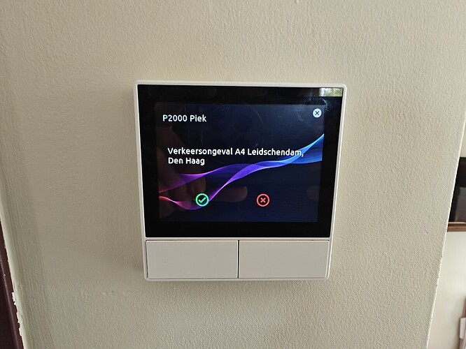

I wanted my Sonoff NSPanel to alert me whenever there’s an emergency service call nearby. So I vibe-coded this custom integration, which closed a nice loop: I receive the raw P2000 pager messages via an RTL-SDR dongle plugged into the same Raspberry Pi that runs my Home Assistant.

My automation: the NSPanel receives a notification on any urgent call within 2 km, and when bursts of activity are detected nearby. Useful? Questionable. Fun to build? Quite :-).
