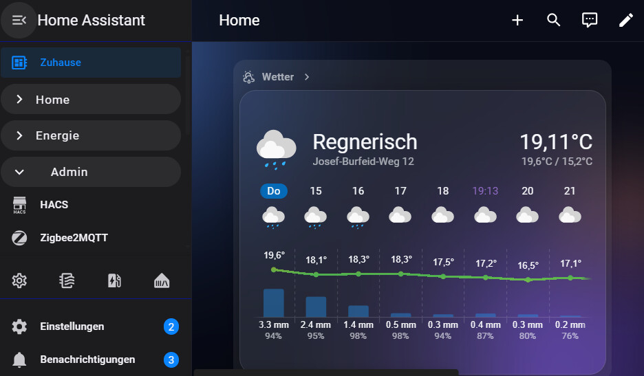

I actually use a different theme (ios Theme) for the sidebar than for my dashboard (liquid glass).
But I made the background of the group button lighter to get more contrast and use I the rounding.
I have a main group that starts open while the other 2 start closed. Only one group open at a time.
And I have 4 Buttons in a bottom row.
What I am missing most on sidebar organizer is an easy way to roll out the settings to all devices.
Thanks for the screenshot @Fugazzy! Good news on your main wish: Easy Sidebar Pro stores the layout in Home Assistant itself, per user, so it’s the same on every device and the companion app with nothing to copy. As admin you can also press Set as default for everyone to roll it out to the whole household.

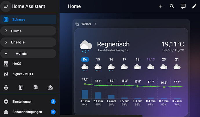

Hey, that was fast!
I switched to v0.3.0 and it really works fantastic! For now I tested it on a desktop and on my iPhone with my user. Different users need to wait till the evening.
UX got a big jump with this one now working!
I noticed just a small optical issue: On small screens the background of the active group get smaller than the none active ones, while on large screens these are well aligned. (even if you make the browser window small)

Thanks @Fugazzy! Both are fixed in v0.3.1:
  • On phones, group headers now have exactly the same width as the other rows, so the highlighted page no longer looks shorter than the headers.
  • New option under Display in the editor: “Hide the number of items on folded groups”.
Update in HACS, restart, refresh the browser.
