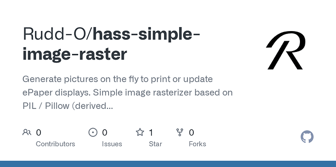

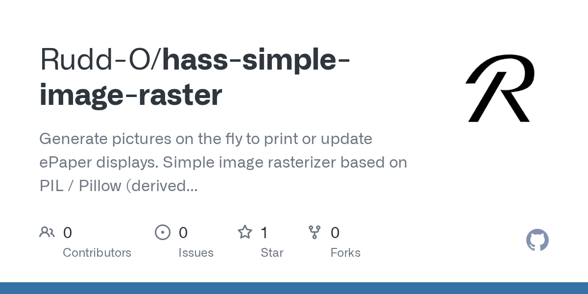

I’ve recently create a drawing extension for Home Assistant:
How can we integrate your work so that these epaper displays can get pictures they drew themselves in HA using my integration?
Thanks!

Hello @Rudd-O,
just for my understanding, your drawing extension creates images you would like to push on the ePaper display?
If yes, the simplest way would be storing those images in a folder on HA for allowing paperlesspaper integration to pick it up for upload to the eInk Paper.
I have considered allowing my integration to write files to disk, but it would be fairly easy for someone with a little bit of elbow grease to overwrite important files in the Home Assistant directory, and then therefore destroy Home Assistant setups that way. My integration also has the ability to read files, but it can only read files from data: URLs or from HTTP URLs, because otherwise it would be very easy to exfiltrate important configuration or passwords or secrets data from the home assistant directory.
Of course, no one is stopping people using my integration from chaining the output data that the integration produces into a shell command that decodes base64 and writes it to a specific file on disk. That is actually extremely easy and can be done with a script and a little bit of configuration on the home assistant side. Perhaps this is the most expedient way for anyone to use my integration to draw arbitrary pictures and then put them into files that the paperlesspaper integration can use.
