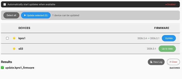

  • Centralized dashboard — View all ESPHome devices, their firmware versions, and status in one place
  • External dashboard support — Connect to an ESPHome dashboard running on another machine (e.g., a separate build server)
  • Dashboard authentication — Support for username/password authentication on external dashboards
  • Mixed setup support — Use both local ESPHome add-on and external dashboard simultaneously
  • Batch updates — Select multiple devices and update them sequentially with a single click
  • Individual updates — Update a single device directly from the panel

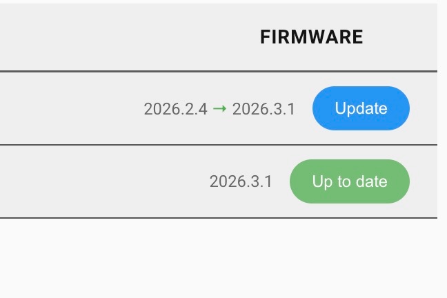

This morning I finally had the opportunity to test this integration.
While everything worked great I cannot seem to leave the main page anymore.
When there is no upgrade in process I can swipe from left to right and the home assistant menu appears. When updates are in progress no menu appears, it just bounces a bit to the right.
This is on iOS. Is this generic or something I’m doing wrong?

Problem solved! issue was the buttons on the right falling outside viewport and blocking touch events, preventing the sidebar swipe.
Tested on a small iPhone 12 mini and it’s working as expected now.
When using even smaller screens, you need to use the device in panorama mode as a workaround.
Fix is available in release v1.2.4
EDIT: made an additional improvement for small phone screens in release v1.2.5

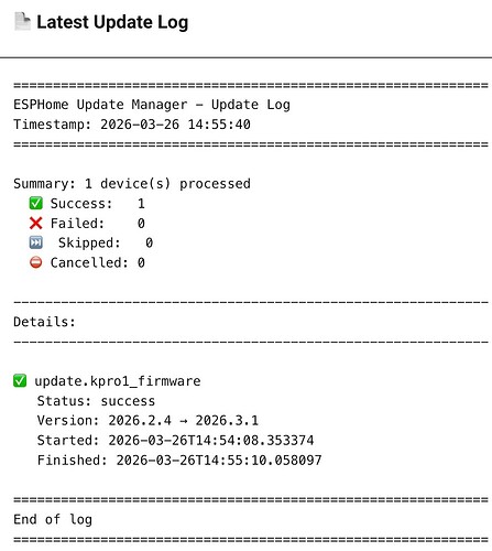

  • Automatic log backups: After each update batch completes, the update log is automatically backed up with a timestamp
  • View previous logs: Access to previous and 1 latest update log via the new menu in the header
  • 3-dots menu: New menu button (⋮) in the top-right corner for quick access to logs
  • Latest Log: View the most recent update log
  • Previous Logs: Browse through historical update logs

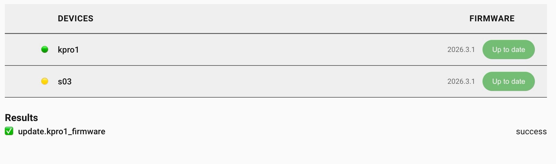

maybe I have something different wrong. I updated the other device, that was ready for update from 2024.2.4 → 2026.3.1 with ESPHome Update Manager. The system was “pretending” that it updated, the ESP Home Update Manager was catching the update, saying “Up to date”! and getting green.
log seems to be fine:

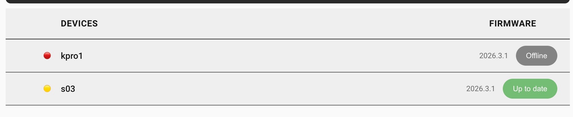

Than the ESP went in deep sleep again, ESP went offline:
When it woke up it was showing
as if no update was happening.
Any ideas?
all the best
Juergen
