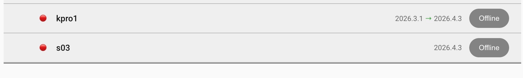

So this is what I see when I did the Update on my S03 manually:
Before is also had the older 2026.1.3 → 2026.4.4 like kpro1 in the line above. When it came up, I got the checkbox for updating, which I checked and than klicked on the “UPDATE” all button above.
But after 5 minutes, there was no update shown. I pressed cancel, it “did” something, but the end was, that I had to reboot HomeAssistant. As I seemed the ESP was not having a working firmware version, I than did the update with ESPHome and it worked as expected.
After this, I cannot update the ESP any more with ESPHome Update Manager, as I cannot klick the checkbox any more.

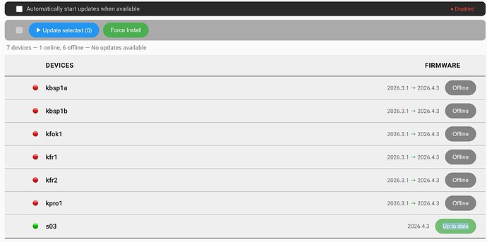

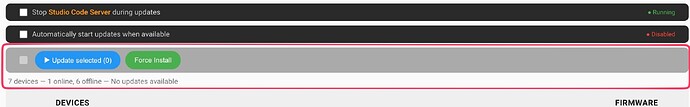

Hi @Krivatri,
I can confirm it works now for me. Except my general problem ist, that most of the time, my ESP are in deepsleep, so offline. The marked buttons are not listet than:
So what I would need is to have the change to select and force force update even if all ESPs are asleep.
So I can test manually the final version, and than check all other ESPs that should get this version.
So my problem ist, that I cannot tell “upfront” that things should happen, but I have to wait for each and every ESP when it is online and than do the update.
I hoped that I could mark them all for “Install”, press “force update”; and than the ESP Update Manager “waits” until they are not asleep any more, and than updates them when they go online once in a while.

ok, if I understand correctly, you need to be able to select offline devices in the panel so when they come online, they get a force install?
Yes, exactly. Checkmark devices if they are offline (or online) that than get a force install. I could even use, if I could call a service in your esphome update, that I can call within an automation. The service would get the ESP I want to update, and I call it, if the ESP goes online, if this makes things more useful.
I think what you need is in release 1.7.0
Please check Pending force install for offline devices and Deep sleep devices
There is also an automation that goes with it to command the devices to deep sleep after a force install

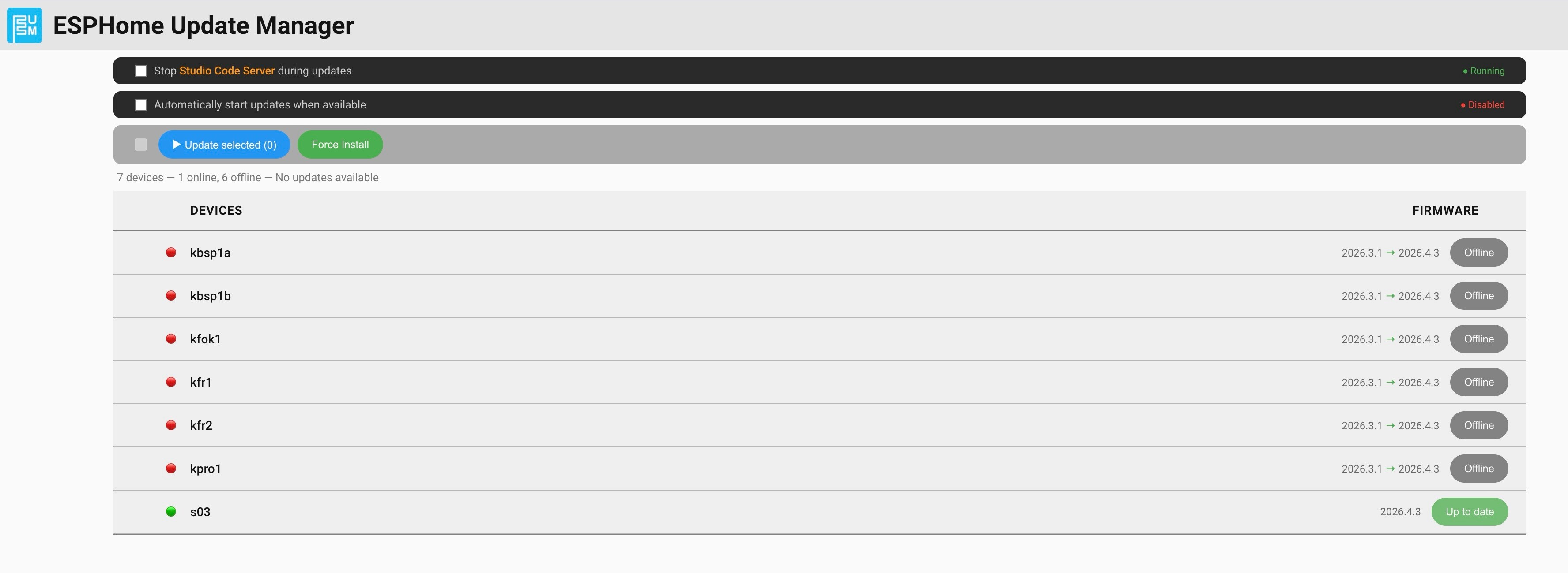

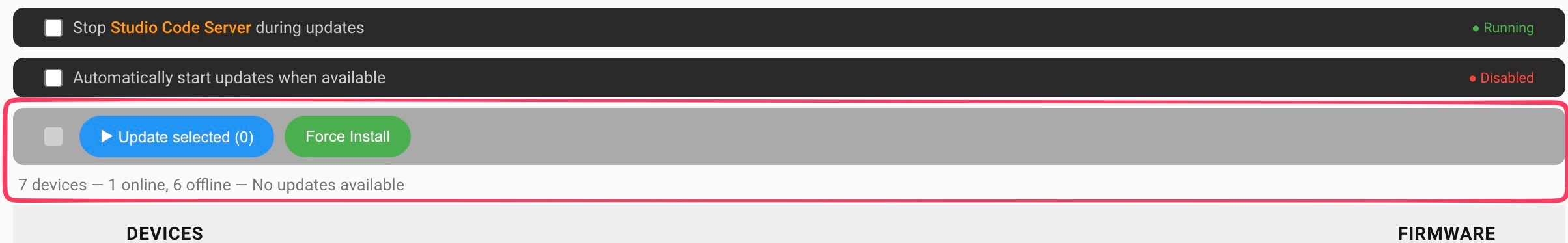

One thing I forgot: At the beginning, I was really confused, that the greep Button for "Force Install" and "Update" where switching. I checked the ESP for Install click the button and nothing happened. Maybe a dropdown would be better as a UI.
thank you
Juergen
I see what you mean, that's why I've used different colors, but maybe it's not enough.

release v1.7.2 is available, please check it out, hope it makes more sense now.
I like it. Esspecially also that there is now ESPHome and YALM version shown. Mabe a space befpre the (YAML)
