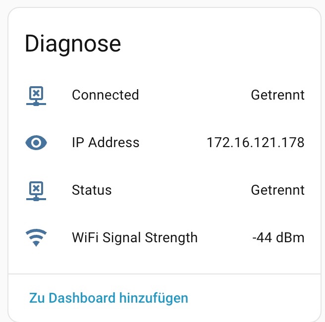

HI,
I have seen your solution in the other thread, but it does not really solve my problem. Google and chatgpt suggest, I have a text sensor in the YAML
text_sensor:
  - platform: wifi_info
    ip_address:
      name: "s03 IP Address"
that exposes the IP Addres. I just tried it, and it works:
So is there a chance, that I can call the API of ESPHome Update Manager and tell to use the IP for connection, not the s03.local?

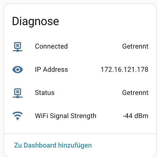

I am just testing, but noticed, that the "wrong firmware" is not happening, when it does the compile (and the ESPHome version is not updated at the same time...) see
thank you so much
Juergen
