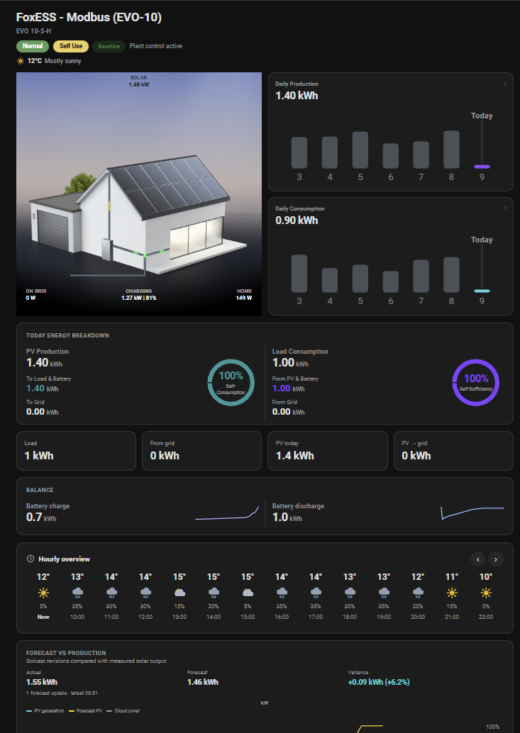

Sadly as a new user I will have to post some extra screenshots on the GitHub as you only get one per post!! Here is the top half of the plant overview page!

Just checked out your Fox Plant dashboard too. You've done a great job replicating the Fox app.
My only issue is that because my solar is generated outside the Fox system, the original Fox app sees this as "Gen load" not "Solar", but your dashboard doesn't see it at all. Not sure if this is fixable?
