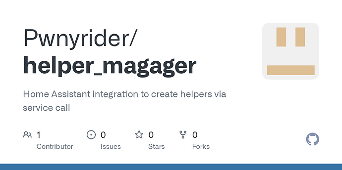

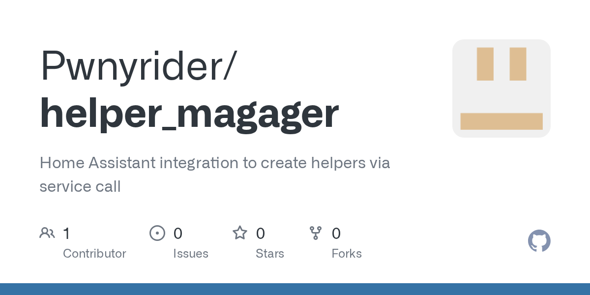

[Custom Integration] HA Helper Manager
I created a Home Assistant custom integration that exposes services for creating persistent helper entities programmatically — from automations, scripts or blueprints — without needing to use the UI or restart HA.
Hope this helps anyone else.
Feedback is very much appreciated!

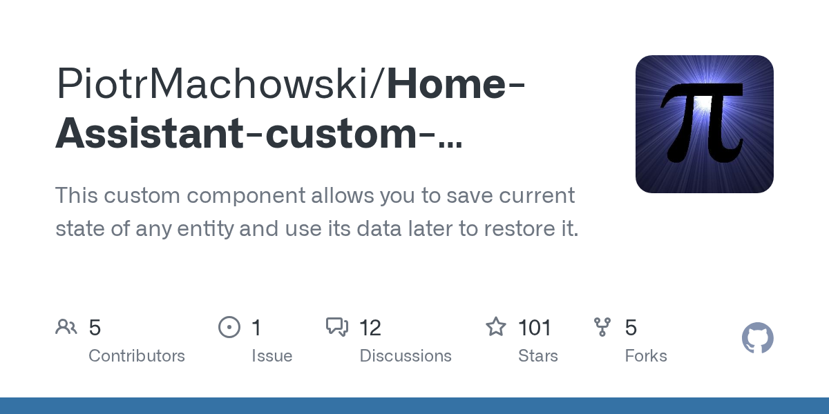

Have you heard about this integration?
I used this extension since a while and it is working really good, especially if you want to counters and timers.
Though, I will think about your suggestion.
Best Regards!
After some deep diving, Helper Manager integration is the best basis for the soliton. Saver is targeted to solve persistence but not lifecycle management - and Saver cannot be used in Jinja templates; a valuable/important need.
