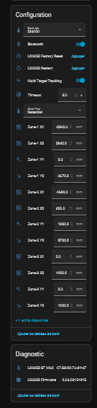

i still haven’t understood what you lack in the BT way and i’m not going to check 2km of screenshot.
the BT way reproduces the HLK app functionalities, so on zones you can set up them and select the functioning mode (detect, exclude, no zone).
This is what the HLK app does (at least, last time i checked)
What the app and the BT way do not do is notifying when a target is in a specific zone. However, you can do it in post processing since the integration returns also coordinates.

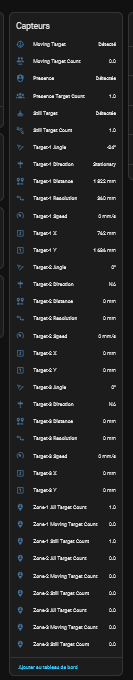

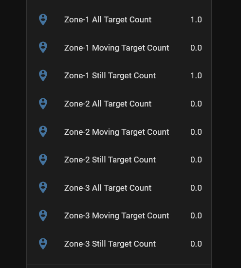

Are you talking about this?
With esphome
With the zone count I can know where the target is in the room and make automation accordingly. With the bluetooth I do not see how I can follow someone in the room through the different 3 zone and light 3 different light according to the position of the target. In one automation I use sensor.mwave_salon_zone_2_all_target_count If Higher than 0 light on
those are calculate and not coming from the sensor itself.
What i’m trying to tell you is that since they are calculated you can either:
  • calculate them in HA based on ble sensor data (template sensors). as far as i can remember i exposed also raw coordinates of targets
  • modify the integration code to calculate these values and expose the variables (i’ve some doubts on this since they are variables linked to one use case only - zones set as detect - and not working in other uses (what if you use zones as exclude?)
