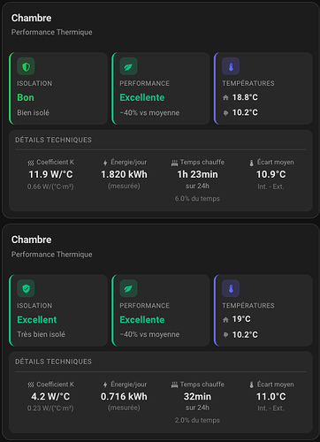

Hey everyone! :wave:
I’ve been working on a custom integration called Home Performance that analyzes your home’s thermal performance using your existing sensors.
What it does
  • :bar_chart: Calculates your room’s K coefficient (thermal loss)
  • :dart: Gives you an insulation rating (A to G)
  • :zap: Tracks daily energy consumption
  • :window: Detects open windows in real-time
  • :flower_playing_cards: Includes a built-in Lovelace card
Why I built it
After buying a 1930s house, I wanted to know if my insulation work was actually paying off. I had all this data from my smart plugs and temperature sensors, but no way to measure real thermal performance.
Screenshots
Installation
Available via HACS as a custom repository:
https://github.com/Hugofromfrance/home_performance
Feedback and contributions welcome!
