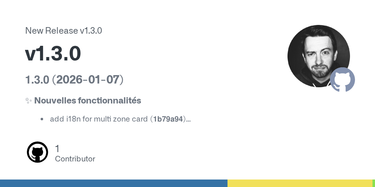

A new release is out.
Let me know if you have some issues :muscle:
