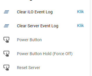

What it does

:gear: Power Control (disabled by default)
All power control entities are disabled by default to prevent accidental shutdowns — especially important if HA itself runs on the same server. Enable individually from Settings → Devices & Services → HP iLO → your device:
Entity What it does
Power Button Short press — graceful shutdown or power on
Power Button Hold Hold — immediate hard power off :warning: data loss risk
Reset Server Warm reboot
Server Power Control (switch) Turn server on/off via set_host_power()

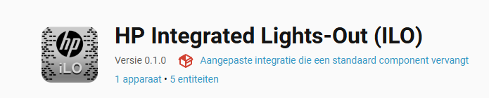

But, not so much entitities.

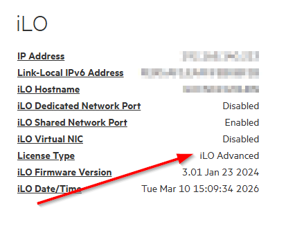

It’s iLO v5 fully licensed

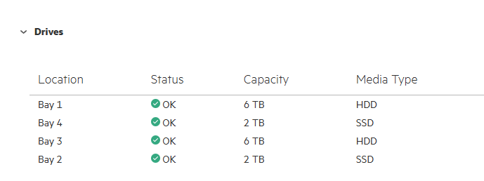

and i can see the disk’s in iLO

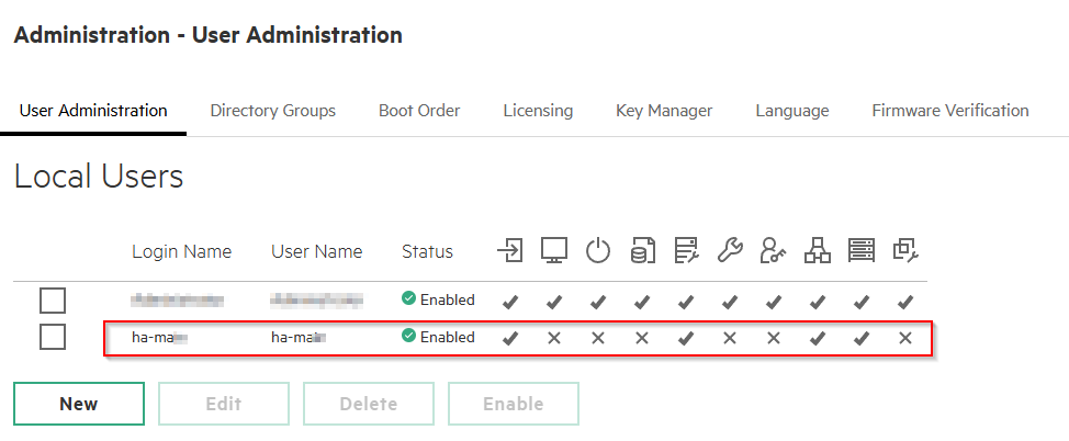

I’m using a bit restricted user
is this a matter of being patient?
I now gave the user all access exept service account, still the same 5 entities.
I did do a reload after the change, no result.

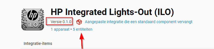

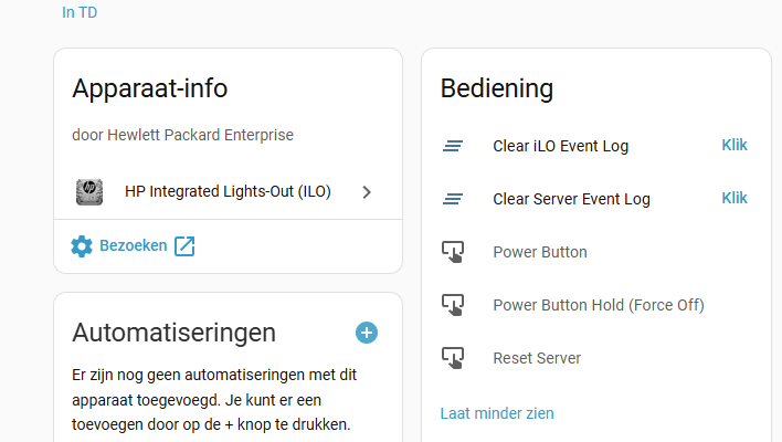

There are no entities shown within the integration, other than the ones shown in the pic you uploaded?
  • i downloaded the .py file but clueless where to place it.
  • How do i enable extensive logging
  • only the entities in the pic

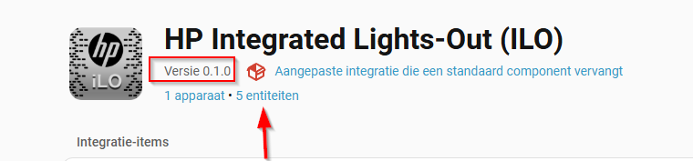

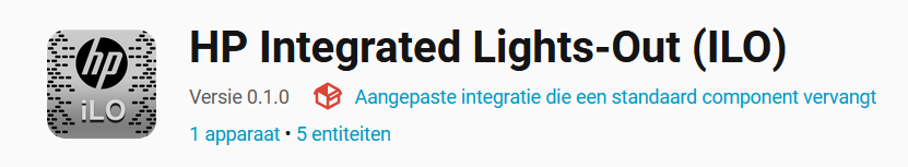

So i installed the update, rebooted entire (proxmox) system, so not only HA,
Result,
As far as i see, no change.
Also;
Looks like a old version (or mistaken identity) but it showed a new version which i installed???
Have installed it and it is working like a charm. 61 entities are shown.
iLO 2.82, System ROM J06 04/04/2019, SPS 2.2.0.31.2,
Good to hear!!! :heart_eyes:
It seems that you are not using the custom integration mentioned here but rather another version.
Go to HACS and enter the custom repository mx5gr/ha-hp_ilo-revamped . If you want more info on how to do that, see here → Custom Repositories - HACS
Afterwards, from within HACS, download the integration " HP iLO Integration for Home Assistant" (v2023.3.2). You can see the relevant version/publisher information before you download the integration, thus choose the correct one (if multiples exist).
Reboot HA.
Last, but not least, go to Devices and add the integration/device combination.
Reboot HA.
Done…
