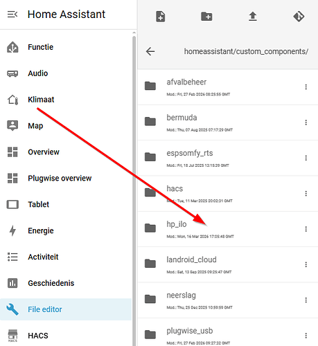

  3. removed al vissible file in the custom componenst folder wth file editor. Unable to remove hp_ilo folder, i guess still some hidden files.

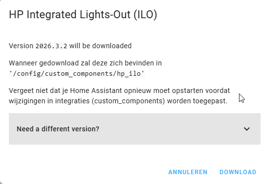

  4. downloaded version 2026.3.2

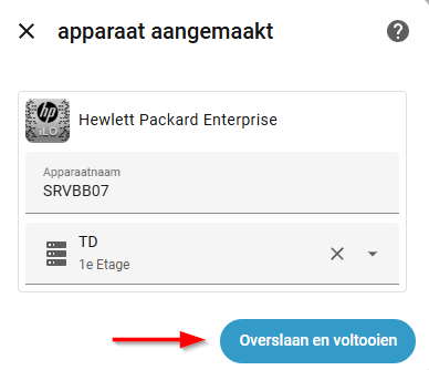

  8. gave it a name and location and klicked on button (weird because is says skip and conclude

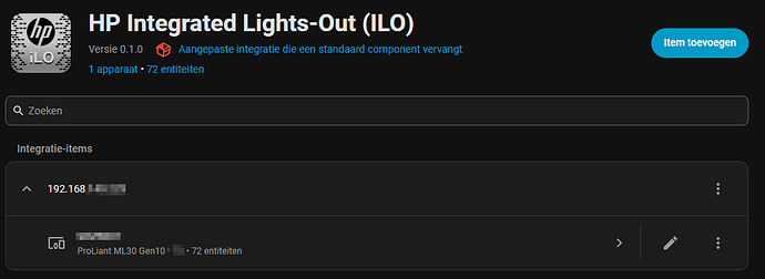

  9. and again showing v0.1.0 and ilo with 5 entitiies

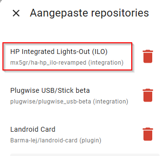

As far as i can tell i’m using the correct repositories

Your steps seem correct. The 0.1.0 as a version number is a bug, it will be fixed in a forthcoming release.
