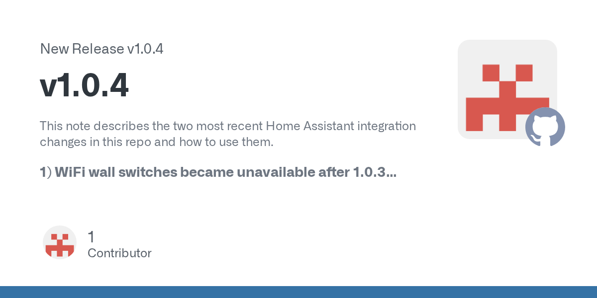

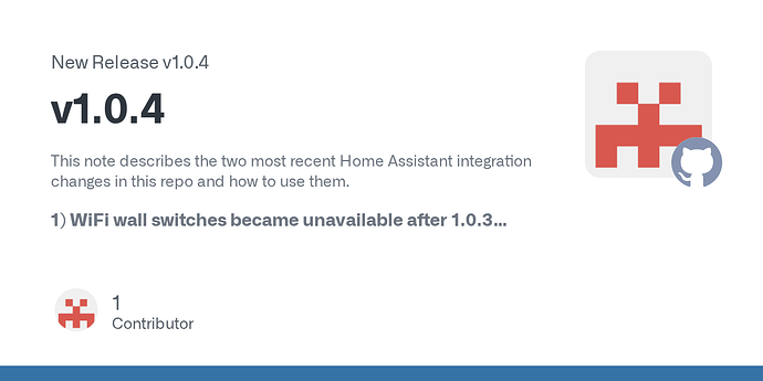

Hey @pockeras
The mapping of the operation buttons was initially implemented to match the Android app, so the issue is likely not with the app itself but possibly due to the motor being installed in reverse.
Depending on the type of curtain or roller shutter device you have, there should now be an option to invert the direction directly on the entity. If it’s not available on the entity, there’s also an option at the Livolo level where you can choose which devices should have inverted direction.
Please check the release notes for the latest version here:
Thank you so much :pray:t3: it works now with version v1.0.4!
