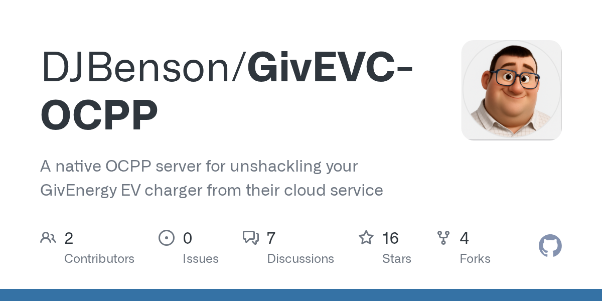

One for the UK peeps - you'll likely know that GivEnergy went into administration recently leaving the future of their products less than certain. One product which needed liberating from their cloud infrastructure was the EV charger (EVC) as without the cloud, it becomes...less than useful shall we say.
I've written a custom integration which allows fully local control of the EVC using OCPP (which the charger speaks underneath GivEnergy's customisations).
It also has a built in firmware server to allow users to upgrade (and downgrade) their firmware versions all without needing access to GivEnergy's servers.
It has pretty much 100% feature parity with the cloud version including;
  • On-device schedules
  • RFID tag management
  • "Plug and Go/Charge"
  • Power, current and energy sensors
