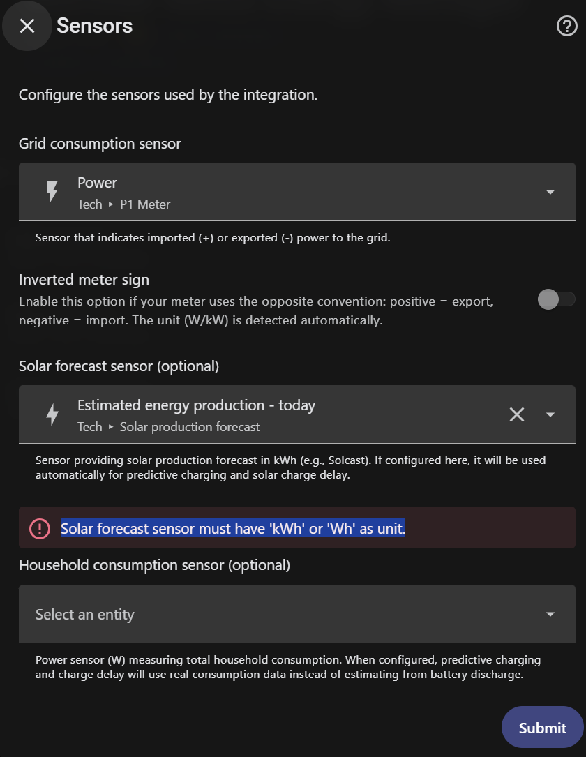

There might be a bug, i am adding my P1 energy import into the sensors, i get the error -Solar forecast sensor must have ‘kWh’ or ‘Wh’ as unit.-
now, the foirecast was previously configured and working, so it seems that the error refers to the wrong input value and both my P1 energy import sensor and solar forecast are correctly in kWh already.
when pressing submit i get the error and the field for the consumption is blanked.
I am not able to reproduce this on my end. Did you figure out what was going on?

Tried with other sensors, readding the solar forecast but it keeps throwing the error. If either solar or total energy sensor are configured is fine, if both are configures it returns the error.

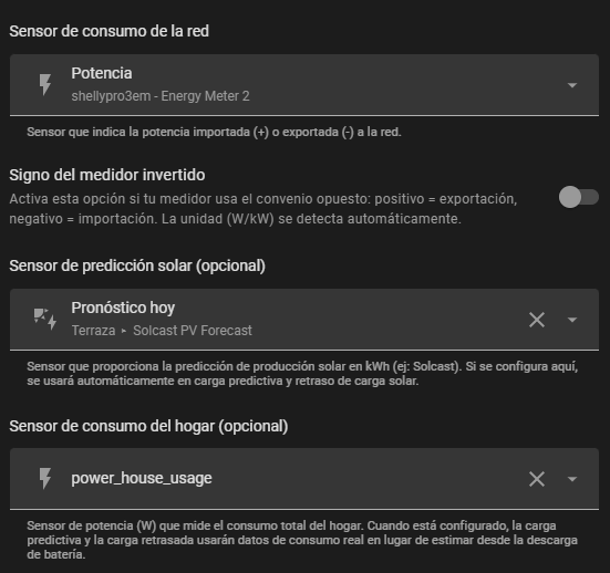

That is weird…I have them both, and I am able to remove them and add them again just fine:
Are you using an energy sensor for household consumption or a power sensor? Needs to be the second.
worked, my error was not using a power but an energy sensor. i was looking at the error message instead of the text.
thank you !
