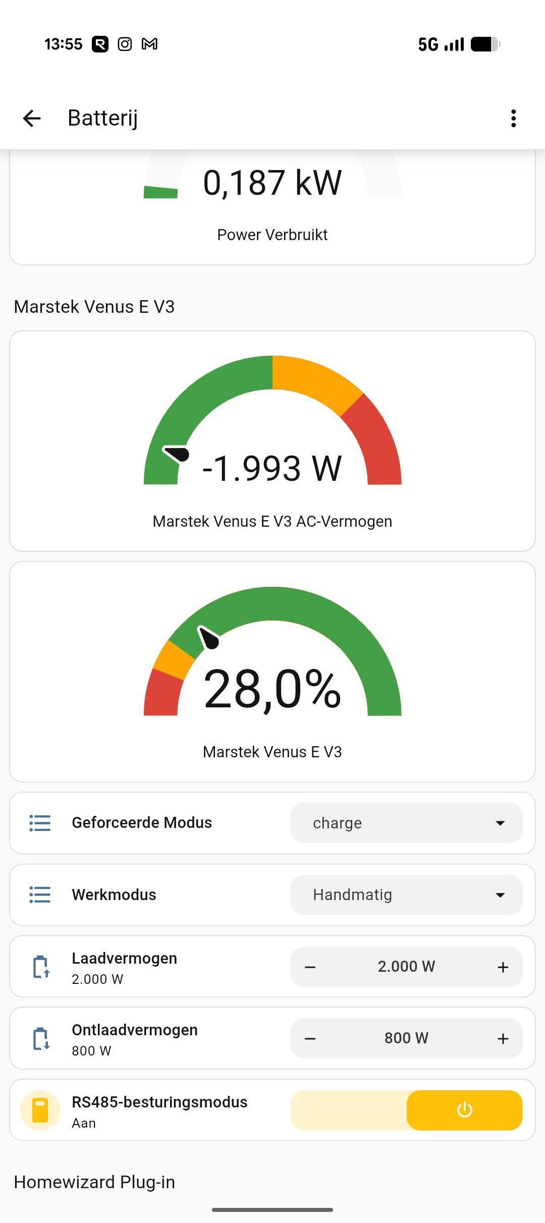

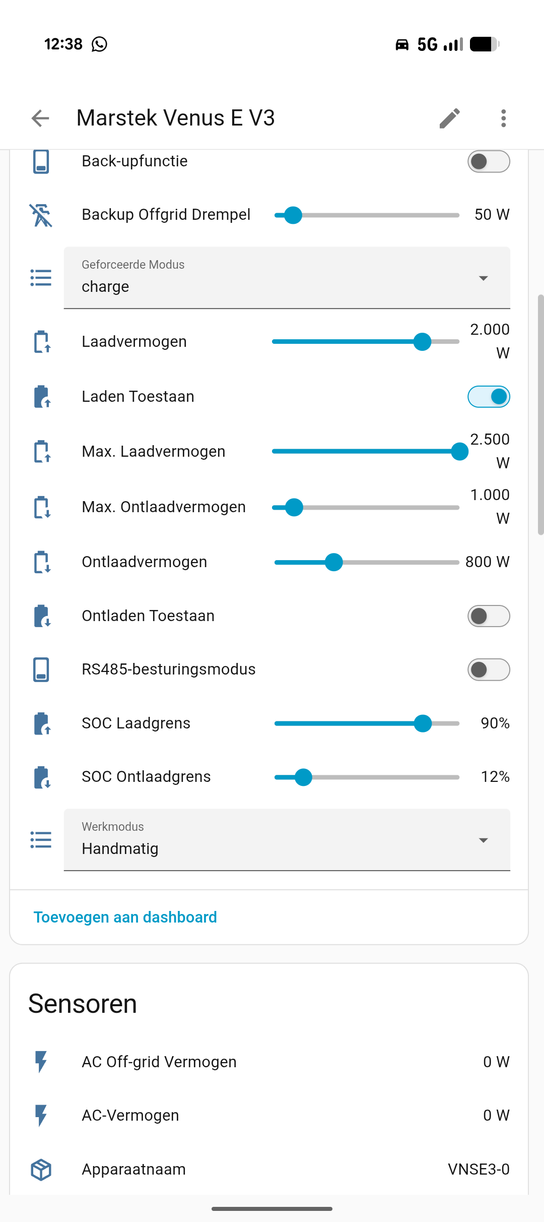

If the manual mode is set to charging, then surely only the excess solar energy should charge the battery, and not a set value like '2000 watts'. The Net zero (only charge) option should then be variable, looking at self-consumption and generated energy, and the Marstek should adjust its charging capacity accordingly. Currently, you can only set this to manual with a fixed value.
The integration isn't designed to be used that way. In fact, there are other integrations out there specifically built to work alongside Marstek's native modes.
The 'Work Mode' in this integration is only there as a backup for emergencies if ever needed, but it is not how the application is meant to be operated. This integration features its own built-in PD controller, which is designed to take full control of the battery without any interference from Marstek’s native settings.
