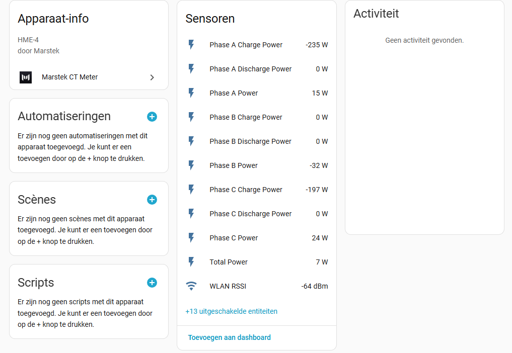

The CT002 can be integrated into Home Assistant using the following custom integration: GitHub - d-shmt/hass_marstek-smart-meter: Custom Integration to get the Marstek CT Smart Meter into Home Assistant · GitHub

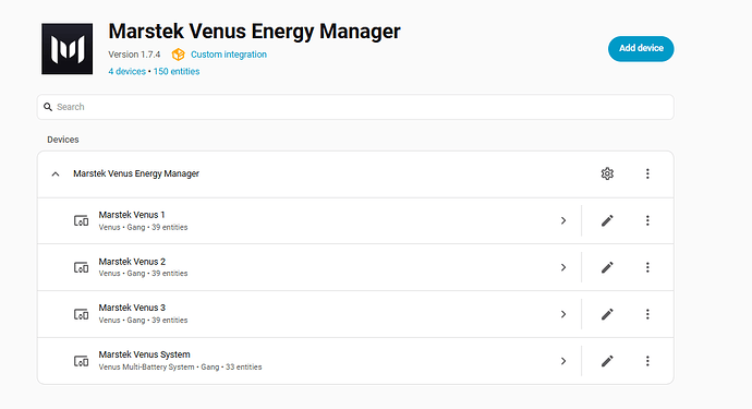

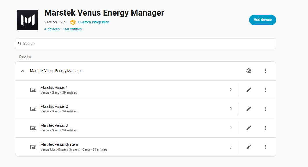

I have downloaded the zip from the github, placed the blueprints in the automation folder and installed the MVEM from HACS some weeks ago. After that i installed the integration which i could configure my batteries and so on. According to the documentation the dashboard should be visible in the bar. How can i install the beta version ?
I see that i had a really old version 1.7.4, i just download 2.0.3 and see if this working now
