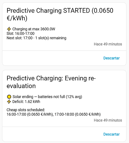

Just in case these notifications are relevant...

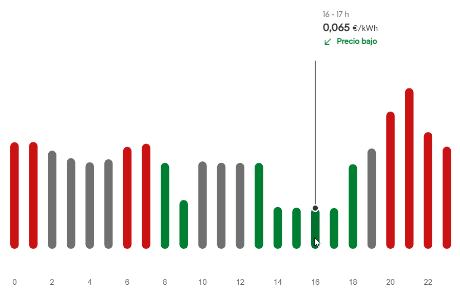

And here you can see that at 14:00 the electricity price was already very low:

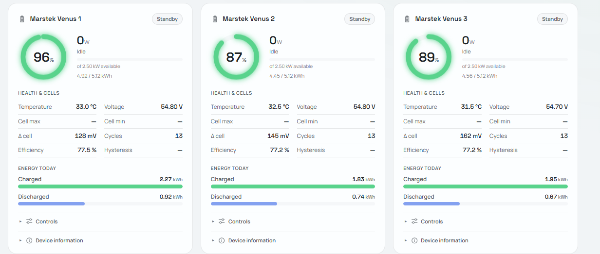

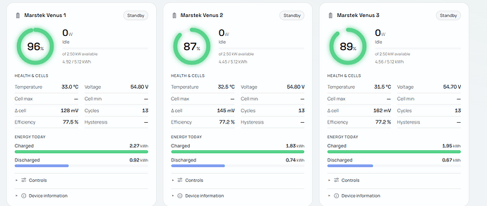

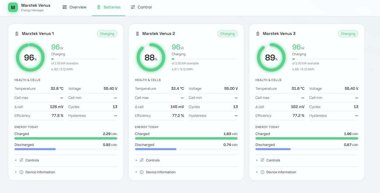

When i first installed the 2.04B pre-release version of MVEM the batteries where charged everytime to 100% with enough unused solar power.
Since i have upgraded to the latest version 2.0.6 i have noticed that on some day's not alle batterijes are charged till 100%, mostly there is one battery charged till 94% and the others till 100%. For example on battery was at 94% and there still a lot of solar power available and was exporting to the grid.

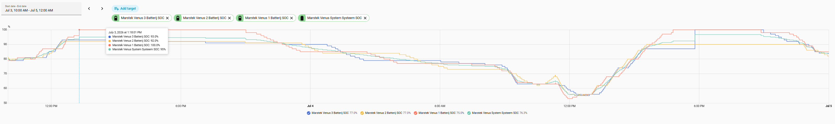

I have checked in HA about the flow and have included a graph.
I found it strange that the charging is not always evenly done. What can be the cause of this issue ?

@ffunes , i was checking today and saw that charging is no longer continued. The status is Battery limited and the batteries are unevenly charged.

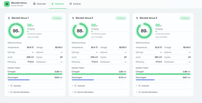

Just restarted the integration, changed max charge speed to 2000W and now the batteries are charging only with 96W, and there is now 3.3Kwh solar power available
After putting the MVEM to manual mode and enabled in the marstek app the mode to self consumption, the status went all to 100%. It seems to be something in reading the correct data from the marstek batteries about the current state.

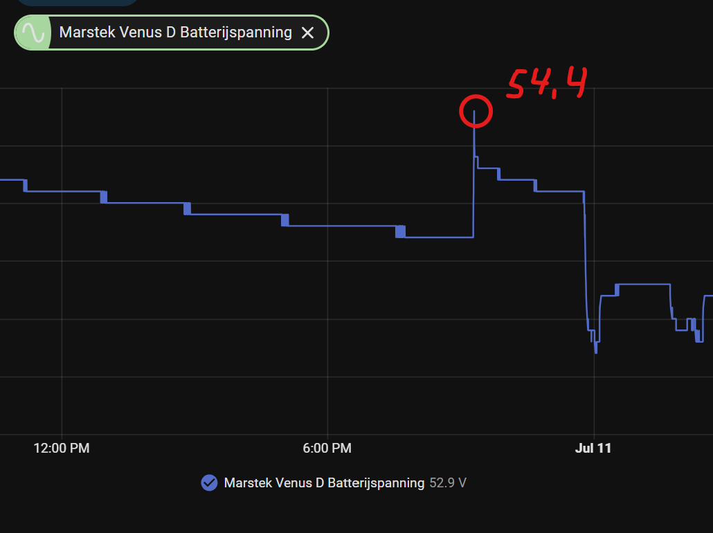

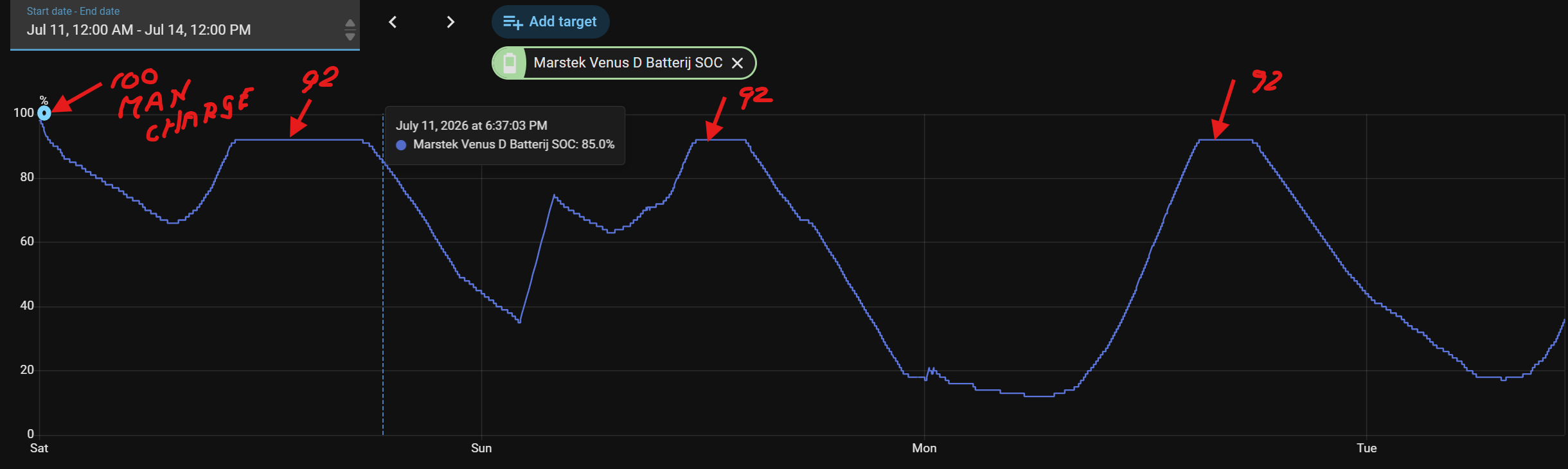

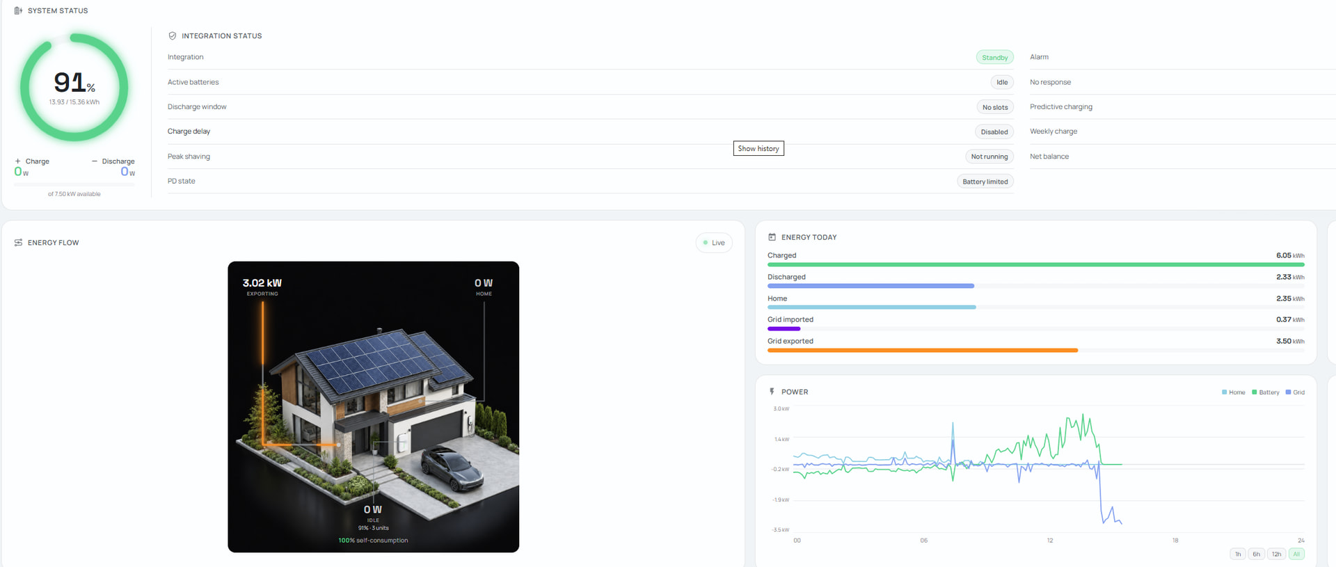

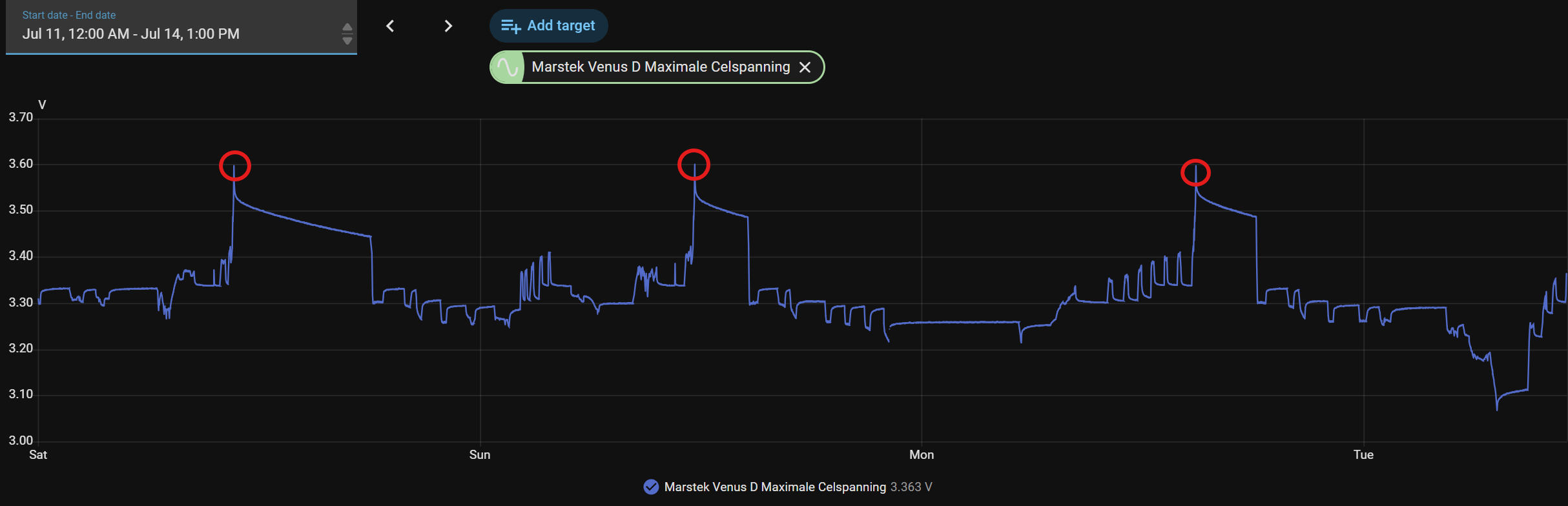

I have the exact same problem with my Venus D! I have 4 packs. If i use the Marstek app and manually charge for a while, all 4 packs reach 100% and are balanced.
If i stop the manual profile and let Omnibattery do the charging i reach max 92% SOC. If i check the 4 packs, top pack is 100% and the packs below are somewhere arround 89%. Battery status is “Battery Limited”. All Solar panel power goes into the grid and does not charge the rest of the battery! During a few days the Balance of the battery is getting worse.
I was reading in another topic : Answer from other topic, [BUG] Soc never reaching 100%
What about unbalance in battery? And pack (from bottom to top) 1,2,3 never reach 100%? Thats where the weekly charge is for?
Added pictures of Manual 100% SOC charge with Marstek App.

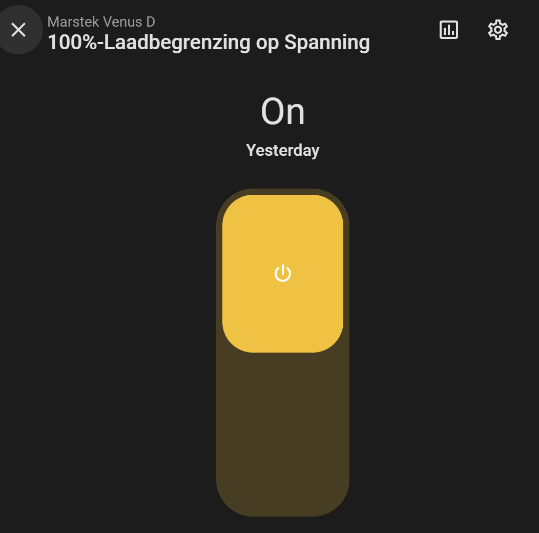

Are you using voltage tapper?
ffunes, thanks for your help and you amazing integration. I am new to this.
How can i check?

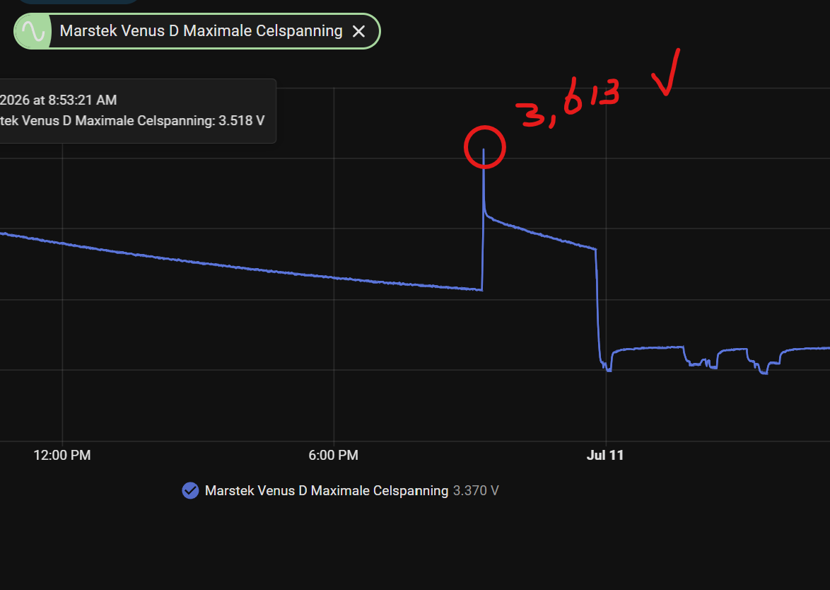

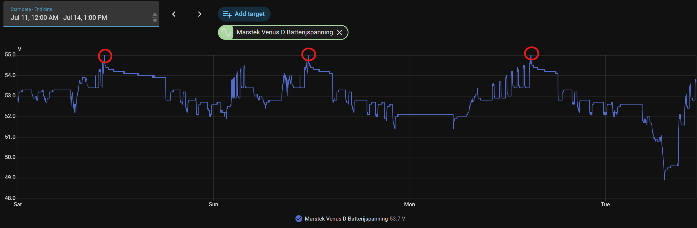

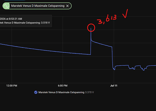

The sensor should be called something like: switch.marstek_venus_1_full_charge_voltage_taper
If that is on, the system will prevent the battery from reaching dangerous voltages (3.6XV) and stop the charge when the max cell voltage reaches 3.58V, however, this will cause that the Marstek BMS won’t report 100% SOC, since the BMS needs to “see” a 3.64V to declare a 100% SOC.
So prevent this from happening too often, in Omnibattery, if the reported SOC is less than 99% the system will allow the charge to continue until the BMS stops the charge, so the SOC can recalibrate.
Please test with Omnibattery first. If the issue persist after running a full charge cycle then open an issue.
Yes, it’s on. So this means it’s intended to work this way?
This i understand i think. It’s a safety messure for the batteries.
This i do not understand? At my batteries the BMS stops the charge for safety because tapering is on. But what happens next i do not understand You say SOC can recalibrate, what does that mean? Now every day the BMS stops the charging and goes to “Battery Limited” and does nothing and all solar power goes into the grid. And the batteries get completely out of Balance.
