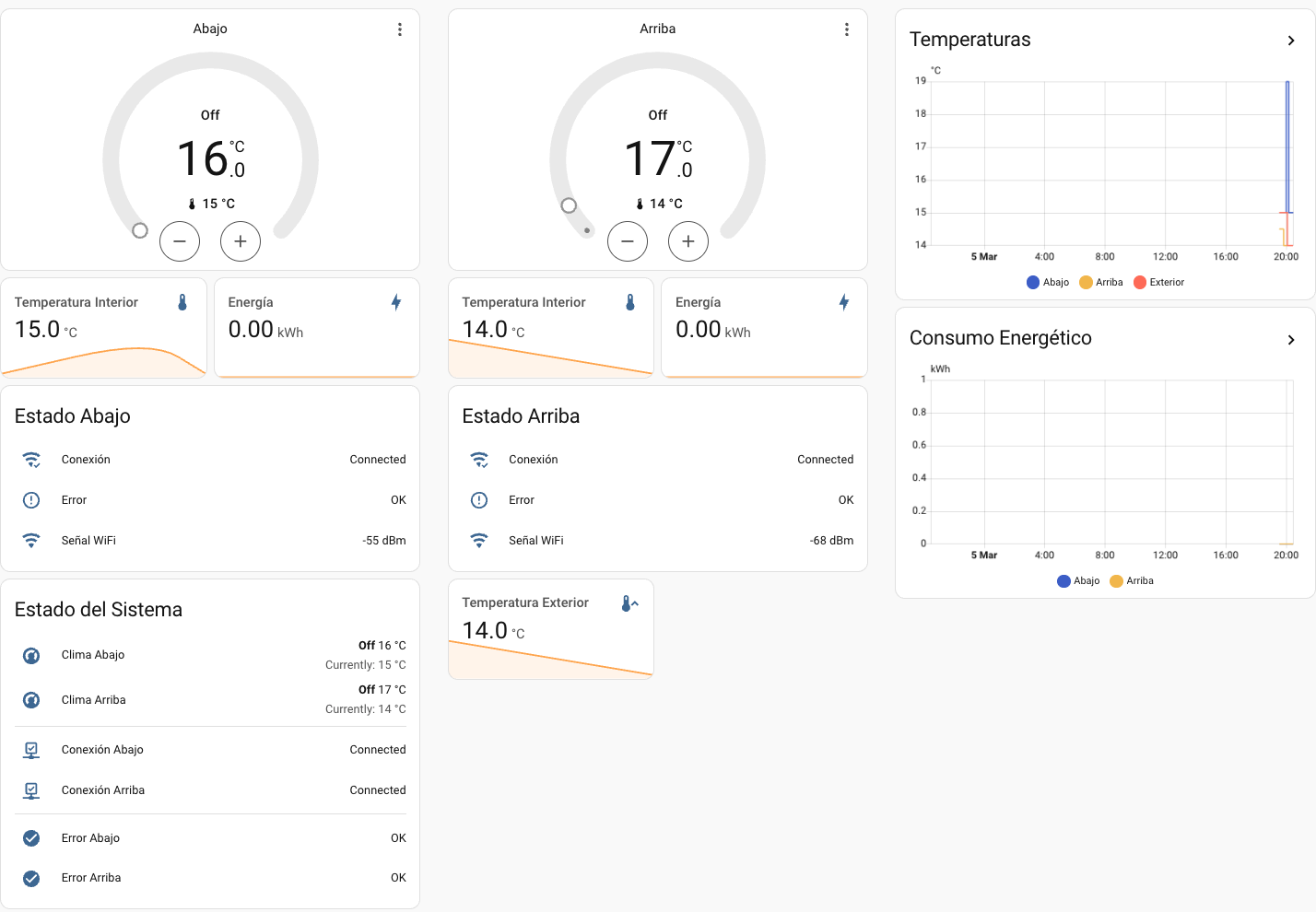

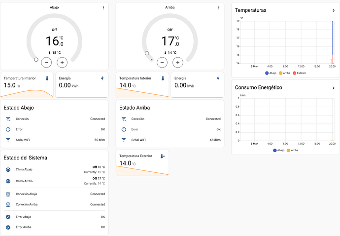

I just installed 2 x MAC-587IF-E into my 2 systems:
  • SUZ-SM71VA & PEAD-RP71JAQ
  • PUZ-SM100VKA2 & PEAD-SM100EA2
So it was 1st time I was able to use Melcloud Home, I found your integration just after realizing Melcloud integration was not for me :smile:
I created a simple dashboard with all entities available. Happy to see other dashboards to capture some ideas.

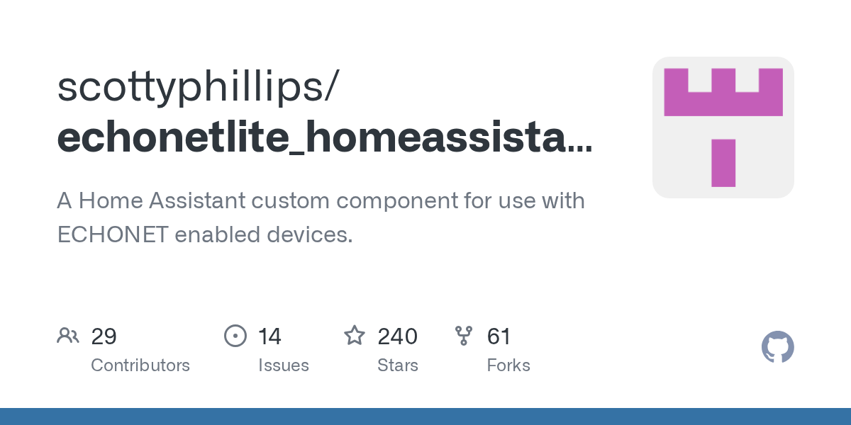

Have you tried the HACS integration? It is local one and many wifi modules are supported.
