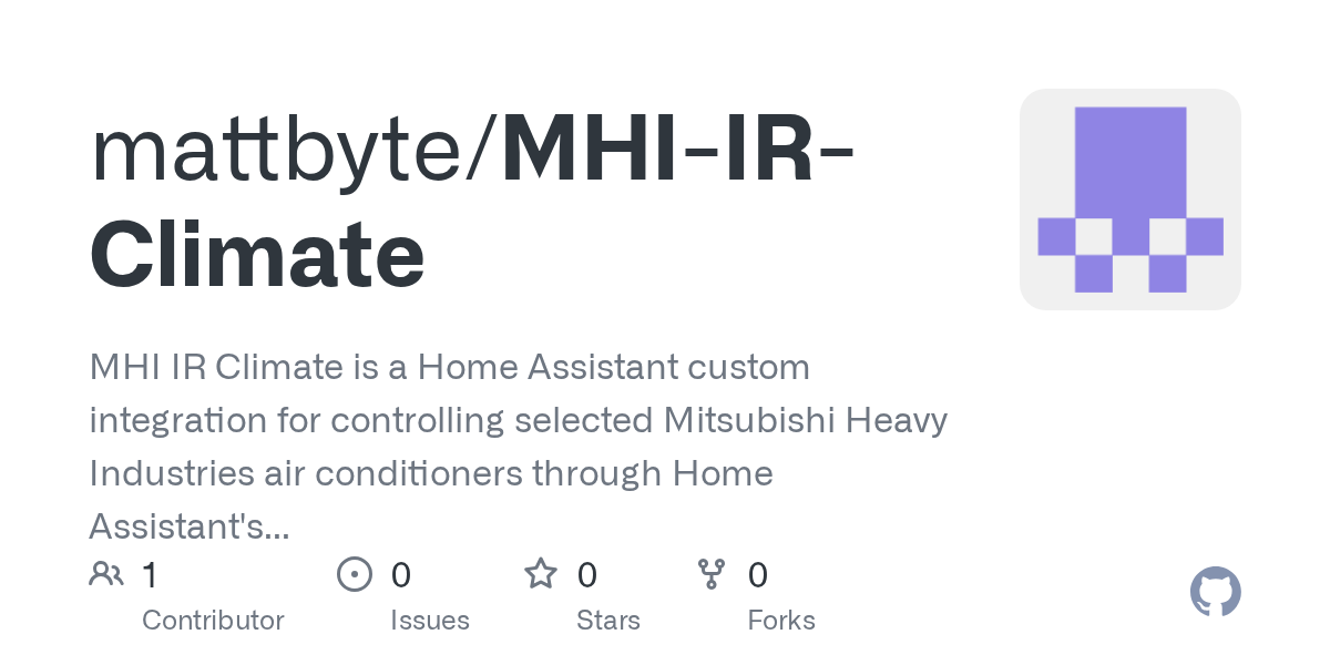

Installation
The integration is currently available as a HACS custom repository.
  1. Open HACS.
  2. Select the three-dot menu and choose Custom repositories.
  3. Add:https://github.com/mattbyte/MHI-IR-Climate
  4. Select Integration as the category.
  5. Download MHI IR Climate.
  6. Restart Home Assistant.
  7. Go to Settings → Devices & services → Add integration.
  8. Search for MHI IR Climate.
Repository and full documentation:

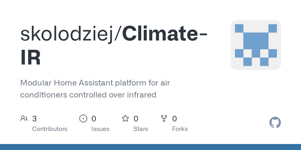

Thanks for this, @mattbyte. Your ZSA encoder is what got my setup working.
My own unit is a Mitsubishi Heavy FDTC40VH from the commercial FD line, which speaks a completely different protocol. I reverse-engineered it from captures and restructured the integration so that each remote family lives in its own profile, which makes adding a family a new file rather than a change to the entity.
22 families so far, but only two are verified against real hardware and the rest are marked accordingly. If you own one of the untested ones, confirming whether it works is the most useful thing anyone can contribute.
