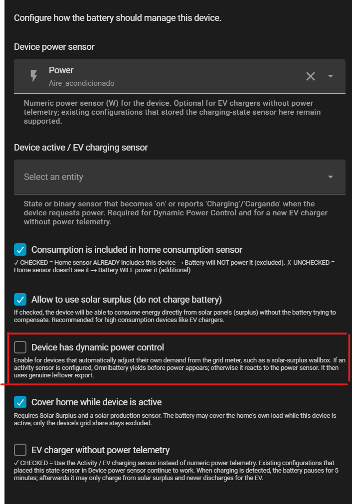

Thanks for your words. I have included a new functionality in a beta version (v1.0.1b6) based on your comments.
  • Dynamic power control for telemetry excluded devices: a new per-device setup option and runtime switch lets flexible loads such as self-regulating wallboxes claim changing PV surplus before battery charging. It uses the existing device power sensor, yields battery charge on startup and meaningful solar rises, holds short device pauses for five minutes, and then lets the battery absorb genuine residual export. A shared device-active / EV-charging state sensor closes the cold-start gap before measured demand appears and also serves new no-telemetry EV setups; legacy no-telemetry setups that stored their state sensor in the old device-sensor field remain fully compatible. The existing Cover Home setting is now also available in both the initial and options flows.
Would you mind testing it and see if this works in your setup?

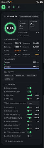

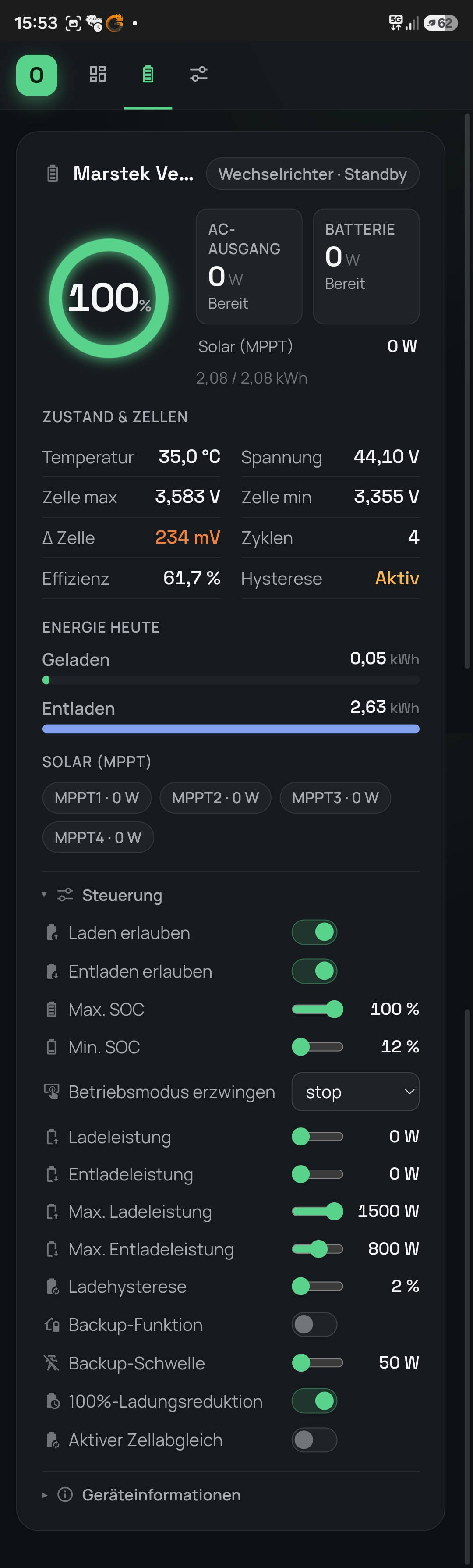

Hi my Venus A just stops at 100%? No discharging…
Also my delta is at 230mV is this a Problem?

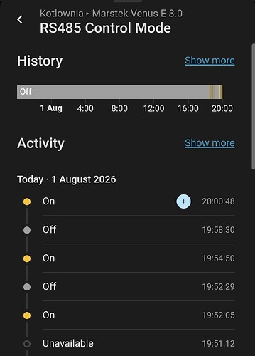

When I turned on the RS-485 switch today I noticed that it is flapping:
Is it normal behavior?
BR,
Tomasz
No, that is not normal. Do you have any other modbus integration installed or using the app for managing the battery?
I have Marstek app, and my battery can see CT002 meter. Shall I factory reset the battery and do not pair it with the CT002? What mode to set in the app?
Maybe I am mistaken by your message, but this integration does not use CT002. I don’t know if you have been able to add that meter to home assistant. Also, there is no mode to set in the app. This is an standalone integration, you can’t use the app and the integration at the same time.
I have another meter connected to Home Assistant.
What do you mean by “use the app” - if I run the app from time to time to check something, but do not change any setting is it ok, or it collides with your integration?
That is fine. But if you make any adjustment in the app, the RS485 switch will be turned off.
Hmmm, this sounds good, but unfortunately the integration does not behave this way.
I exited Marstek app to be sure it is not working in background.
I went to settings → apps and forced the app to stop.
Disabled the integration and reenabled it.
Pls see the log of the RS485 switch:
Last action was manual. Unavailable was when the integration was disabled.

Thanks for the quick response and the beta implementation! I’ve tested “Device has dynamic power control” over the past few days. Here’s my feedback:
Setup:
I created a binary sensor helper for the wallbox (set to off when offline or when EV battery is fully charged). The original wallbox status sensor didn’t work well—it has ~7 different states, and the integration couldn’t reliably map all of them.
Observation 1 – Stable solar, single-phase charging:

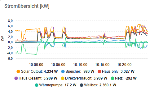

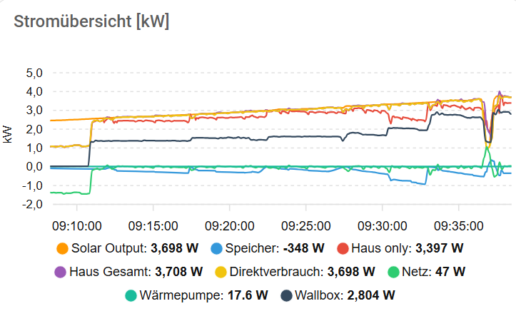

With stable solar output (~3.7 kW), the wallbox charges single-phase and should have priority over battery charging. However, I notice the battery still charges slightly during this time, taking a small portion of available surplus that the wallbox could use. The wallbox’s single-phase max capacity is 3.6 kW, so ideally all surplus should go there first.
Observation 2 – Fluctuating solar, phase-switching:
When clouds pass and solar output fluctuates, the wallbox takes 3–4 minutes to switch from single-phase to three-phase charging. During these short windows, should the battery attempt to charge the surplus, or would it be better to have a longer “hold” period to wait for the wallbox to complete its phase-switch? Currently, the rapid switching causes some minor inefficiency.
Overall: The feature works well and is much better than before. I hope this feedback might also help other users optimize their setups.
