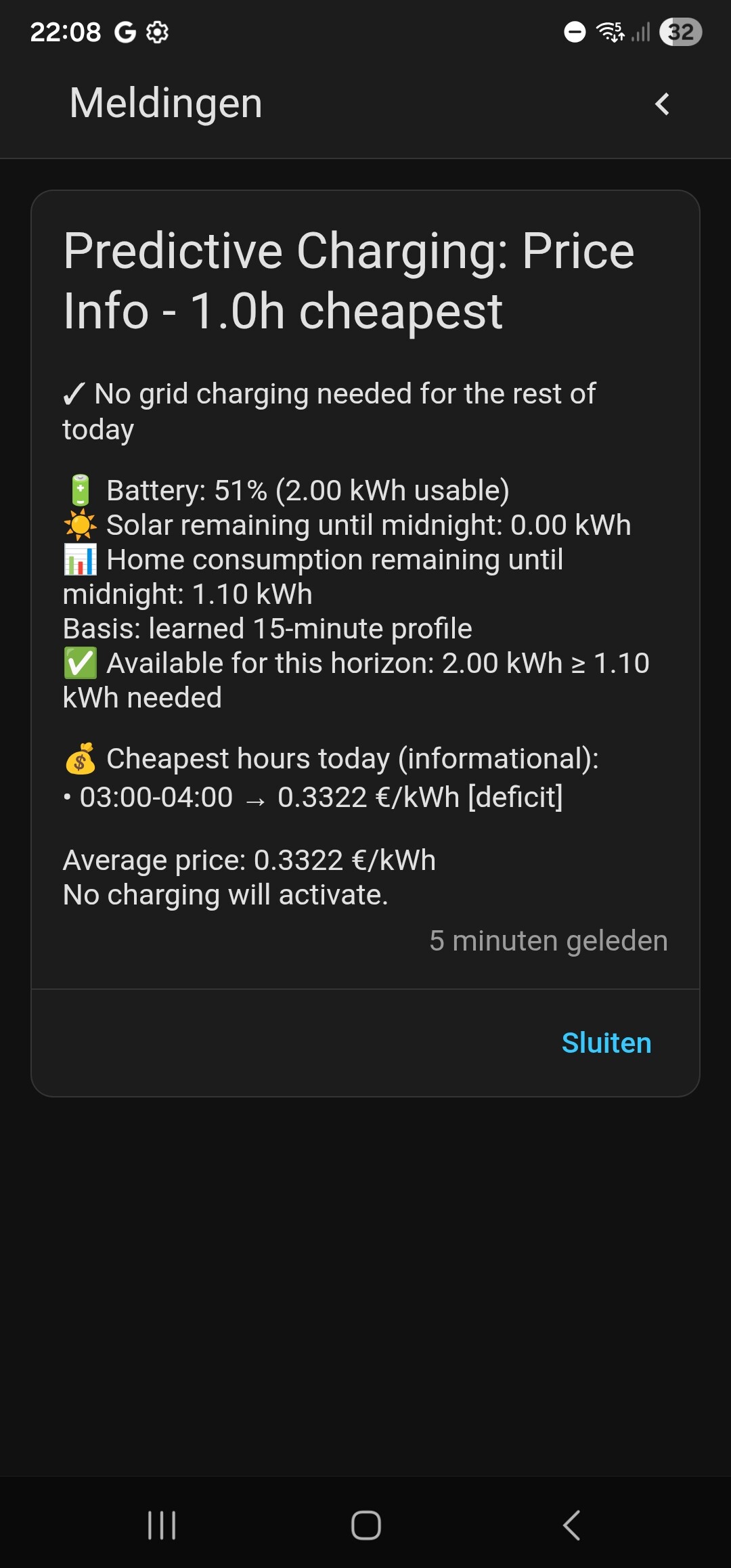

This recalc of predictive charging is run at 10pm.
Why does it only look at the home consumption till midnight? And not till next morning or moment that PV will start generate sunpower?

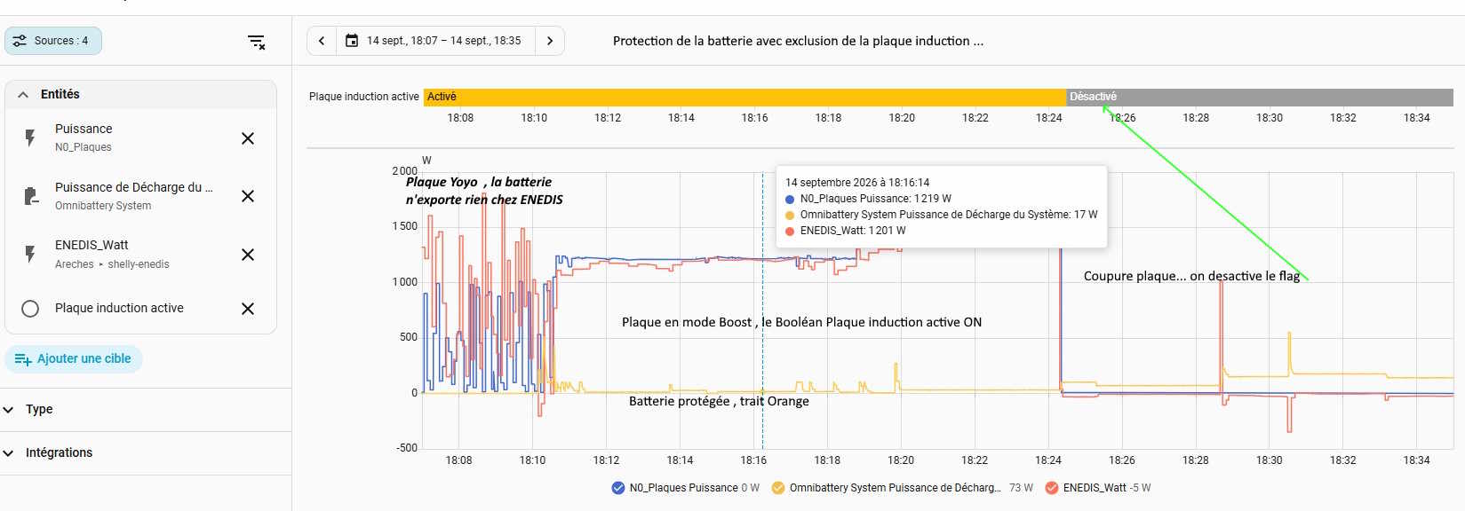

Induction cooktops cause interference in the system; I am going to try to isolate this device.

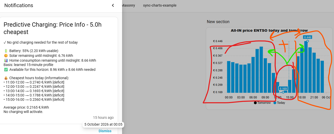

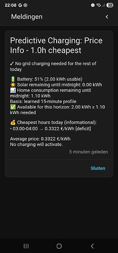

Really happy with Omnibattery already! While the predictive charging looks at the day from 00:00h, it misses the required energy for the time between sunset and the next day cheapest hours.
See the image below. Right now the required energy is looked at from 00:00 till midnight. In that case the battery will run out of juice around 3h till 400h. Right before the expensive morning is coming. I know the next day prices won’t be available unitl 14 till 15h hours each day. But the pattern is often very similar, with peaks in de morning and beginning of the evening.
So it would be nice if the calculation would take into account the full requiremend prediction from 00:00h till sunrise for the current day to add to the required eneryg for the next day.

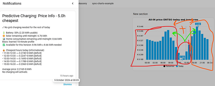

I added the one for NextEnergy 2026 including the Apex chart code to create a graph as in my screenshot of my 5 oktober post.
