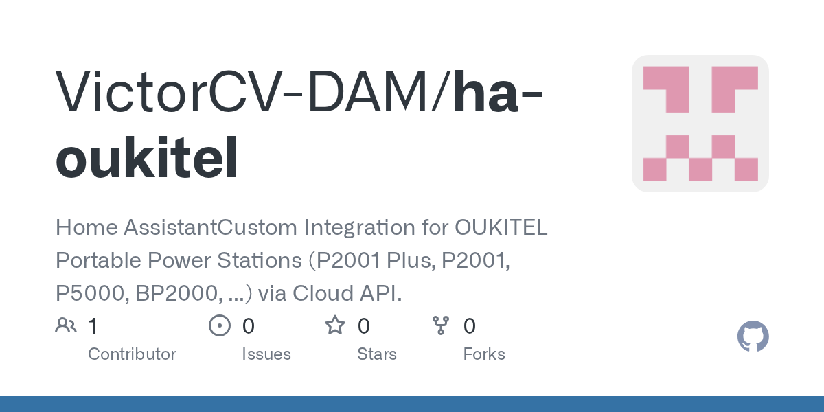

I’ve just published a native Home Assistant integration for Oukitel Portable Power Stations (tested on P2001 Plus, compatible with P2001, P5000, BP2000, etc.).
Key Features:
  • 100% standalone via Cloud API (no smartphone, emulator or ADB needed).
  • Bidirectional control switches: AC Out, DC 12V Out, and USB Out.
  • Real-time sensors: Battery %, Total/AC/Solar input power, output power, internal temperature, remaining times, and Wi-Fi RSSI.
  • Dynamic battery charging/discharging icons.
  • Firmware sleep keep-alive prevention.
  • Configurable polling frequency directly from UI (3–120s).
GitHub Integration (HACS):

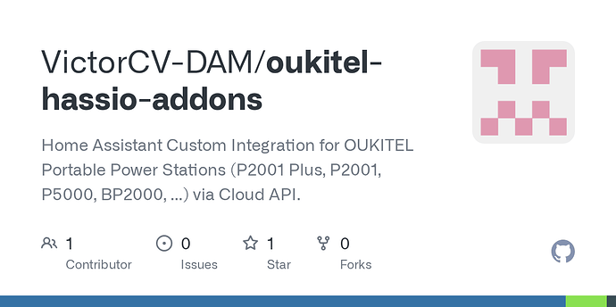

HAOS Add-on Repository:
(A standalone Python MQTT bridge is also available via my GitHub profile).
