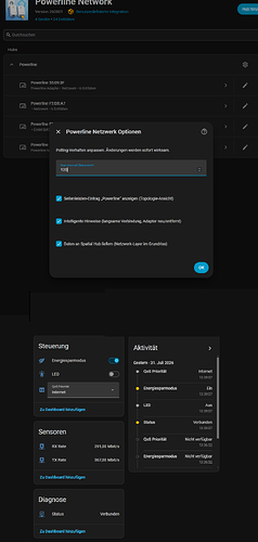

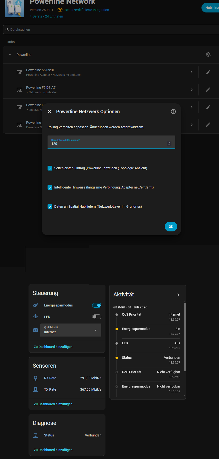

Most powerline/PLC adapters have no IP, no app API, no web page — just an Ethernet cable. This custom integration talks directly to them over raw Layer 2 (HomePlug AV 0x88E1 + Broadcom MEDIAXTREAM 0x8912), the same protocol the official vendor apps use. No cloud, no IP scanning, no port forwarding.
What it gives you:
Auto-discovery of all adapters on the powerline network
Per-adapter sensors: TX/RX rates, online status, firmware
LED and power-saving control, QoS priority switches (adapter-dependent)
Restart button

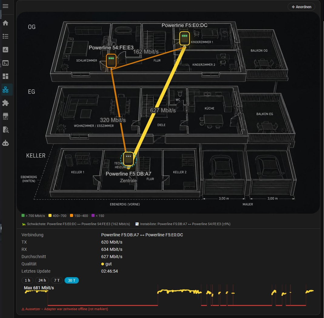

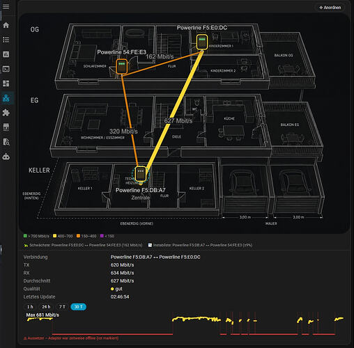

Live topology card — mesh graph of your powerline network in Lovelace
Optional sidebar panel and alerts when links degrade
Verified hardware: TP-Link AV1000 (TL-PA7017, BCM60355) and AV500 (QCA7420), including two AV500s talking to each other. Also supports FRITZ!Powerline (AVM) with LED control and restart.
Safety: config writes are a read-modify-write of the adapter’s own PIB (never a hard-coded image), using the same checksum scheme the vendor app uses. A rejected write is detected and reverted — this will not brick your adapter.
