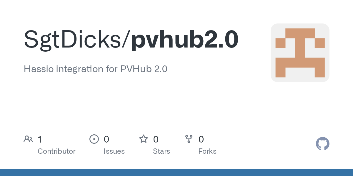

I’ve been working on a Home Assistant custom integration for PVHub 2.0, used by some 1KOMMA5° solar systems.
This is not the 1KOMMA5° Heartbeat API integration. My system uses the PVHub 2.0 portal, so the existing Heartbeat/Auth0-based libraries did not work for my account.
GitHub repo:
