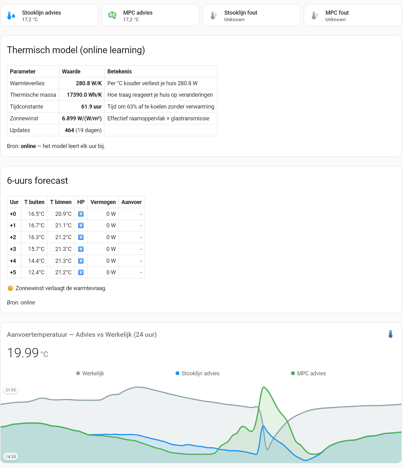

What started as a How is my Quatt heatpump performing, quickly became a ‘can I predict the heating my house will need in 1 to 6 hours from now’.
It uses weather data from Open-Meteo and learns what the impact of solar and outside temperature does with the temperature inside you house.
With a nice dashboard that include a advise on what settings should be use to get the most optimal/efficient heating for your specific house.
It should be possible to also run this on non-Quatt heatpumps, but this has not yet been taken into account.
In dutch (it also supports other languages)
