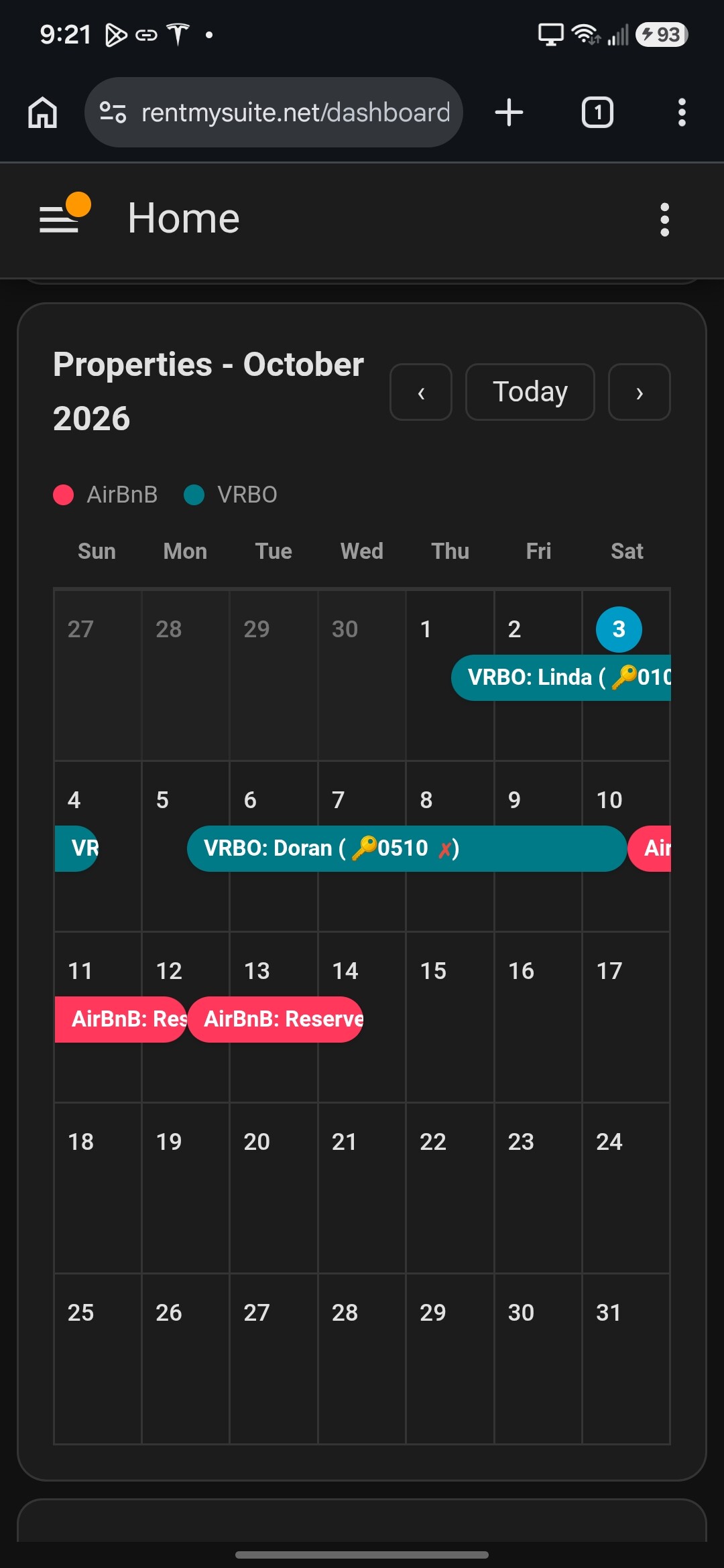

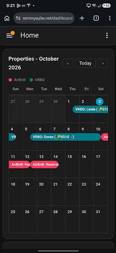

I made some changes to my calendar card not sure if it will work correctly for others but I think it will. What I added was the ability to display the lock code for the booking as well as a green check if keymaster says it’s synced and a red X if it is not.
