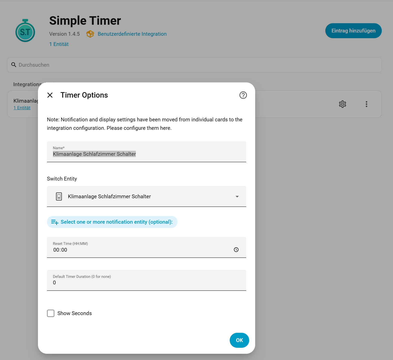

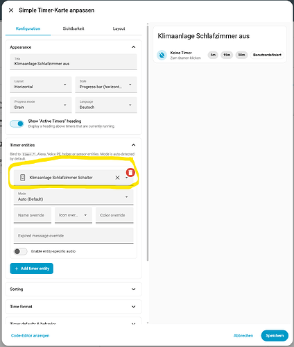

Hi, Does anyone have experience with this? There is a good YT video about it, but apparently something has changed:
Goal: I want to create a dashboard with buttons and various timers to control my air conditioning. However, the AC doesn't have a switch entity, so I need a workaround, because Simple Timer can only trigger switches.
What I've done so far: Created a helper switch (Boolean)
Linked the Simple Timer to the switch
Created a dashboard with the Simple Timer Card
But something isn't right yet. When I save the dashboard and start a timer, shouldn't the helper switch toggle its state? I want to use that state change as a trigger in an automation to turn off the air conditioning.
Where is the error?

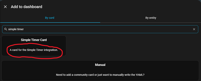

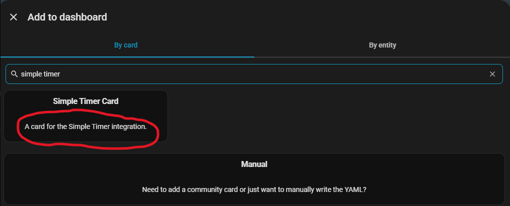

I think you may have confused this with another card.
My Simple Timer integration already includes the card, so you don’t need to download anything else from HACS.
I know there is a “Simple Timer Card” available in HACS, but it has nothing to do with my integration.
Just make sure you select the correct card:
I was struggling with this as well until I saw your post here about another card with that name. It's probably a good idea to change it to "HA simple timer card" or have a note Github of a possible conflict with another card?
