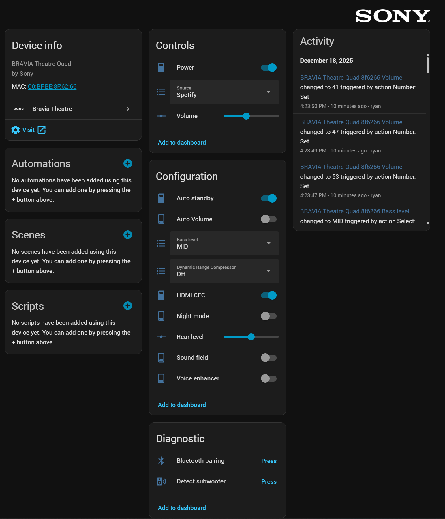

Current Features:
  • Auto-Discovery: Automatically discovers Bravia Theatre devices on your network using mDNS/zeroconf - no manual IP configuration needed
  • Power Control: Turn your Bravia Theatre system on and off
  • Volume Control: Adjust main volume from 0-100 via a number entity
  • Volume Step Interval: Configure a delay (0-10,000ms) between volume steps to smoothly increment/decrement volume, avoiding jarring changes
  • Rear Level Control: Adjust rear speaker level from -10-10 via a number entity
  • Source Selection: Switch between inputs (TV/eARC, HDMI In, Spotify, Bluetooth, Airplay)
  • Bass Level Control: Automatically adapts based on subwoofer presence:
    • With subwoofer: Slider from -10 to +10
    • Without subwoofer: Select between MIN, MID, MAX
  • Subwoofer Auto-Detection: Automatically detects if a subwoofer is connected and adjusts bass level controls accordingly
  • Voice Enhancer: Toggle voice enhancer on/off
  • Sound Field: Toggle sound field processing on/off
  • Night Mode: Toggle night mode on/off
  • HDMI CEC: Toggle HDMI CEC on/off
  • Auto Standby: Toggle automatic standby behavior on/off
  • Dynamic Range Compressor (DRC): Control Dynamic Range Compressor mode (Auto, On, Off) - polls for state changes
  • Auto Volume: Toggle Auto Volume on/off - polls for state changes
  • Real-time Updates: Automatically receives and processes notifications from the device for all state changes (where supported)

I have the Bar 9, I tested quickly and it works.
The integration discovered the device with the right IP address.
The volume control works. It tested some settings and looks like it works. I will report if I found bugs.
Thank you for the amazing work ! :star_struck:
Amazing! just the option to turn on my quad without the remote is priceless!!! Thank you so much!!!
