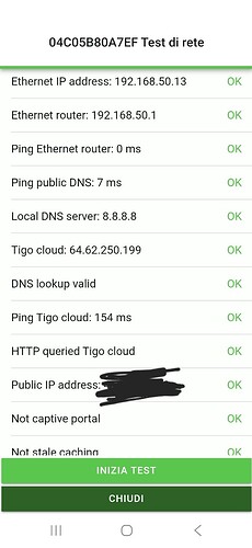

Errore nel recupero device info: HTTPConnectionPool(host='192.168.50.13', port=80): Max retries exceeded with url: /cgi-bin/mobile_api?cmd=DEVICE_INFO (Caused by NewConnectionError('<urllib3.connection.HTTPConnection object at 0x7f5ffc9480>: Failed to establish a new connection: [Errno 111] Connection refused'))
l’IP è corretto e mi sembra ok anche il resto
questi errori devi segnalarli al team tigo, io al massimo ti posso aiutare sull’integrazione mia
Si ho aperto un ticket.

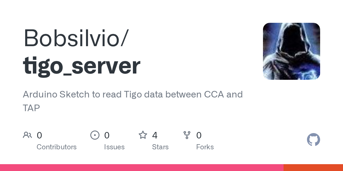

Hi, new update include support for ESP32 project
Only tigo Local GIT
Very good work(reverse taptap), esp32 and local data
Out of curiousity, how is the ESP32 project different than the Taptap implementation that @litinoveweedle is working on? That Taptap project has data being fed directly into HA through the use of an RS485 to WiFi/Ethernet adapter vs. yours using an ESP32 as an intermediary? I am guessing from the bottom graph you are still pulling in the data into HA, but through the ESP32?
Thanks for your work on this. I’m using your Tigo-Local Integration and it works great. I’m still really tempted to use the RS485 line-sniffing methodology though…

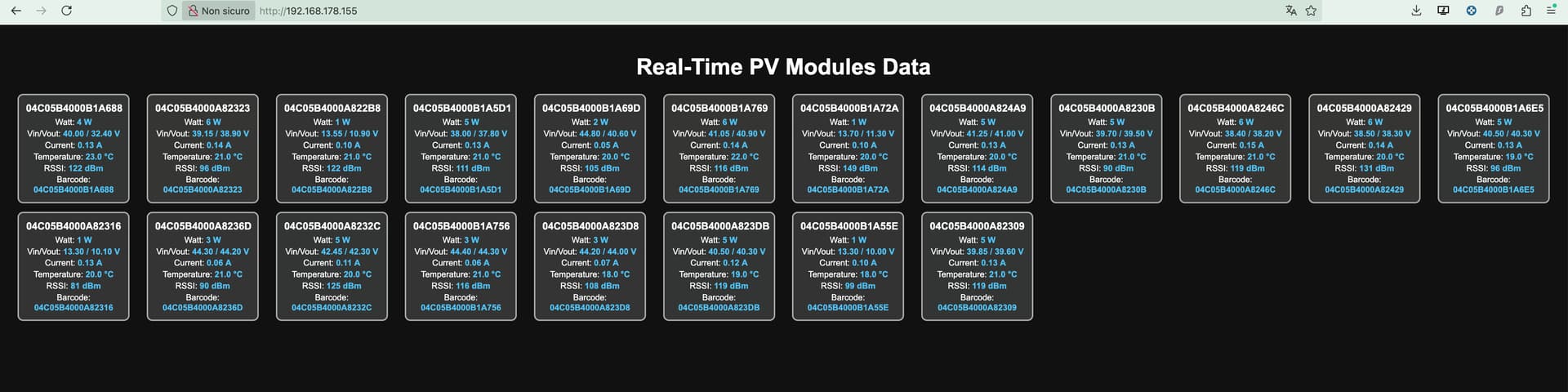

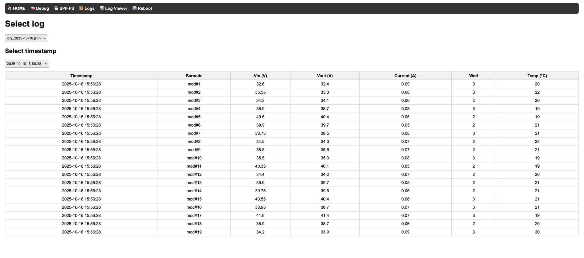

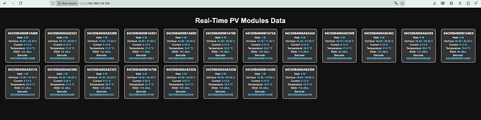

ESP32 uses TapTap code.
For me, ESP32 is still cheap and easy to manage. ESP32 also has an RS485 to TTL interface; you can find everything on AliExpress for less than €10.
There’s also a graphical interface for monitoring the CCA live.
It’s not better, it’s just different, and it’s cheap.
Currently, the data overlaps; the only difference is that ESP32 also receives the temperature.

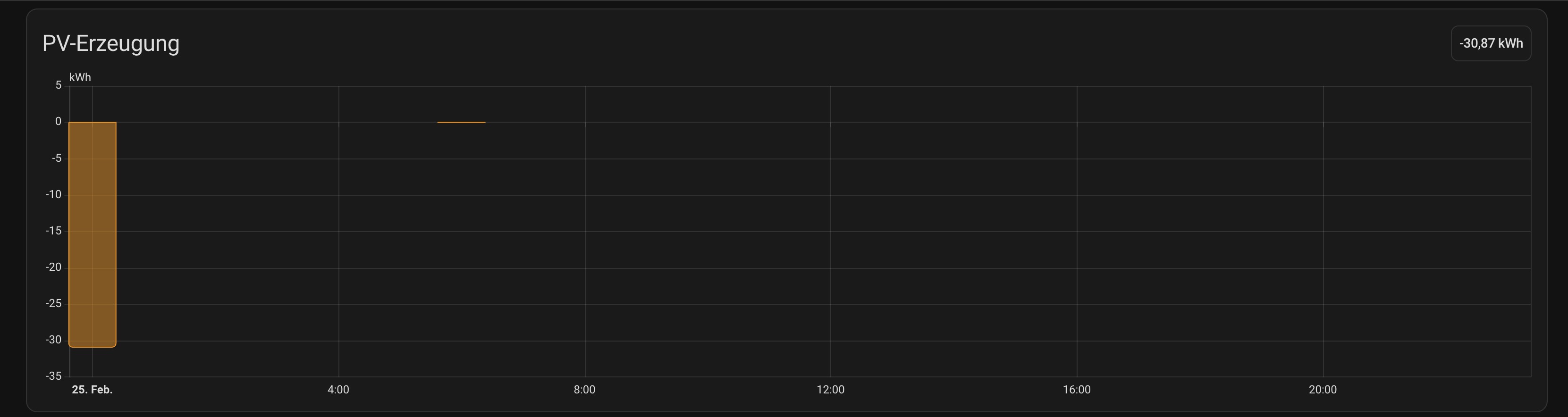

Hello everyone,
I have the following problem with the daily reset.
Are the values from the previous day always subtracted on the “new” day?
How can I get around this?
I am very grateful for any help.
