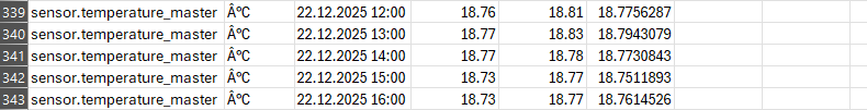

But I have strange value in the unit field for temperature?
instead of displaying °C it display °C

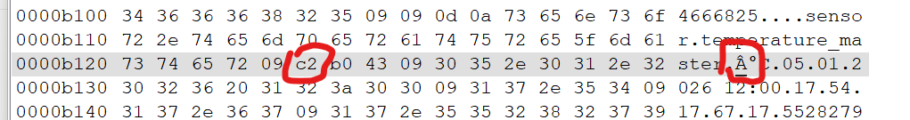

I thought this problem could have been a misinterpretation from Excel, but if I look at the output data directly in hexadecimal format there is an extra c2 char in front of the expected b0 43
any idea why?

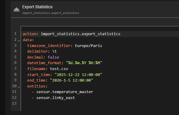

I have used Yaml to run the test but if I switch back to UI mode it seems like the date picker does not show for end_time ? So no way to specify it from UI?
Thats probably a UTF-8 problem. Try opening with e.g. Notepad++ and see if its fine there.

Can it be that the end time in Yaml was wrong? Ah, I see, there are two zeros missing in the end_time (01-05), thats why.
