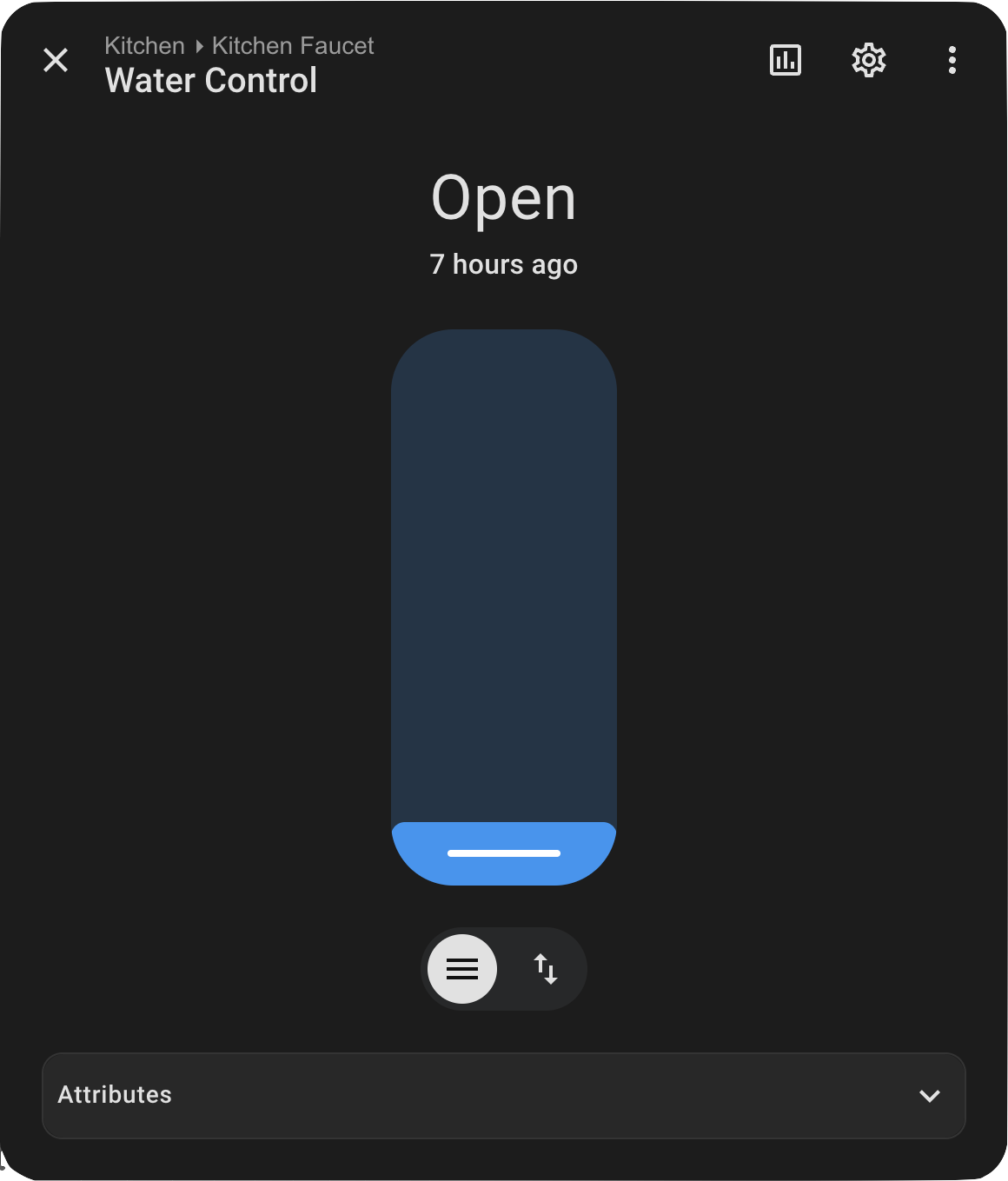

  • Open / close control (valve entity)

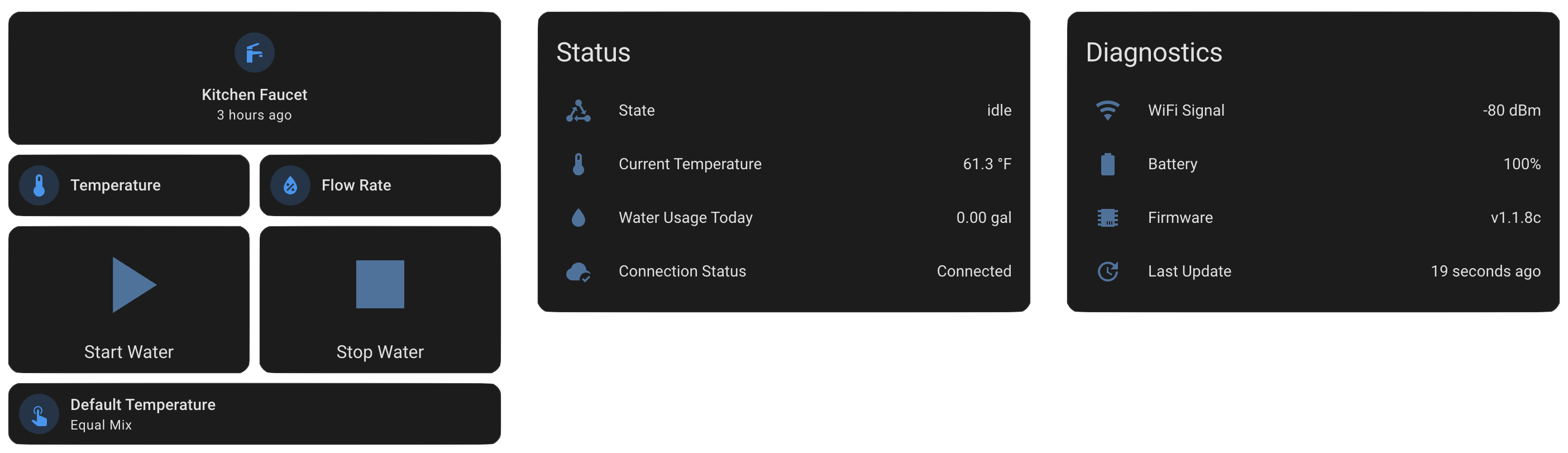

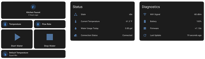

Below are a few examples from my setup showing the entities and controls exposed in Home Assistant:

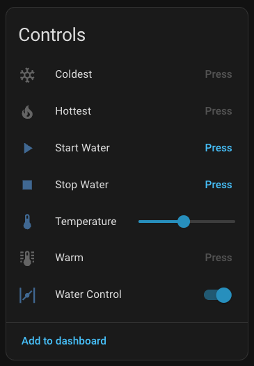

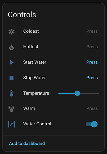

Firstly, thanks for this! I have been using with a Moen Sinema (S7235EV2) and this has been working well.
However, the most recent 1.1.1 update seems to have broken the “coldest”, “hottest”, and “warm” buttons.
Hi @Island_Three — it looks like you had one of my pre-release versions installed. I’ve moved away from those vague buttons in the 1.x.x releases in favor of a temperature slider.
  • If the faucet is running, the slider sends commands to adjust the temperature in real time.
  • If the faucet is not running, the selected temperature is stored and applied with the next start command.
I’ve found this approach to be cleaner overall, but I’m open to adding optional preset temperature buttons back that would start the faucet at full flow using the selected preset temperature.
