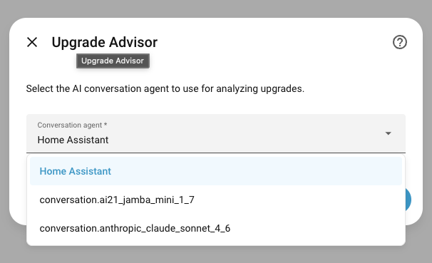

When I try to add the integration, The config flow looks like this and CPU ramps up (on PC accessing the frontend, not the HA Host) and not able to install, nothing in logs
Thanks for reporting this! The issue is in manifest.json — the conversation integration was listed as an after_dependency instead of a dependency. This means the conversation frontend components aren’t guaranteed to be loaded when the config flow renders the agent picker, which causes the browser to spin.
Fix is in this commit: changed after_dependencies to dependencies in manifest.json. Can you try updating and see if that resolves it?
If it still happens, could you check your browser dev console (F12 → Console) for any JavaScript errors while the config flow is open? That would help narrow it down further.

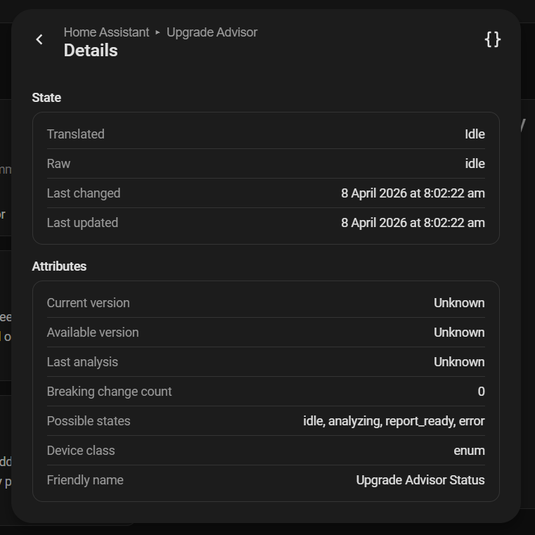

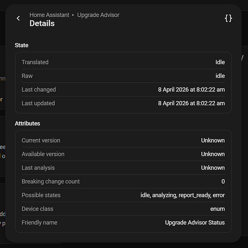

Entities are showing as unknown, apart from Status that is showing as idle, is that correct ?
I get this in the log when running the action:
Log details (WARNING)
This error originated from a custom integration.
Logger: custom_components.upgrade_advisor
Source: custom_components/upgrade_advisor/__init__.py:149
integration: Upgrade Advisor (documentation, issues)
First occurred: 8:02:22 am (2 occurrences)
Last logged: 8:03:26 am
No updates available to analyze
Hi again, thanks for your patience. I think this is normal if you don’t have any pending updates. You should see something next time HA updates or a HACS integration. Add on updates don’t appear (and I can’t think of a way this integration would help).

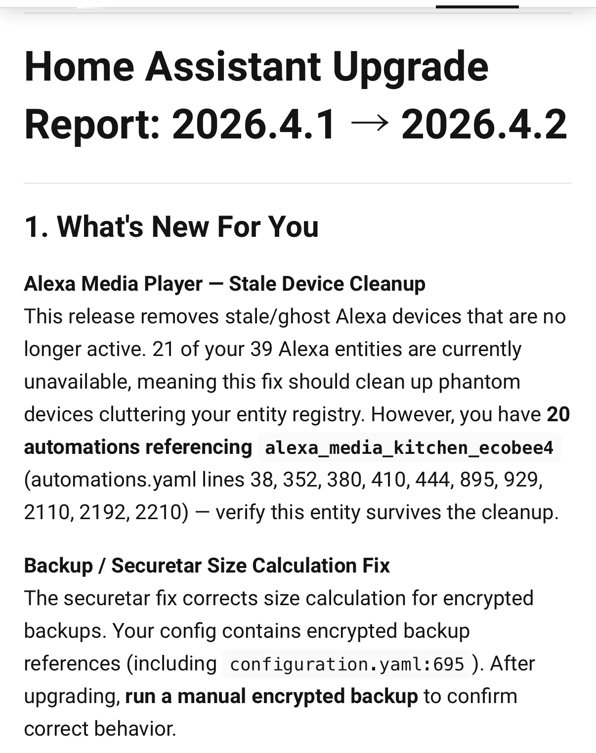

A new HA upgrade just released. You should see an upgrade advisor notice now. And it should be different than my notice :smile:
