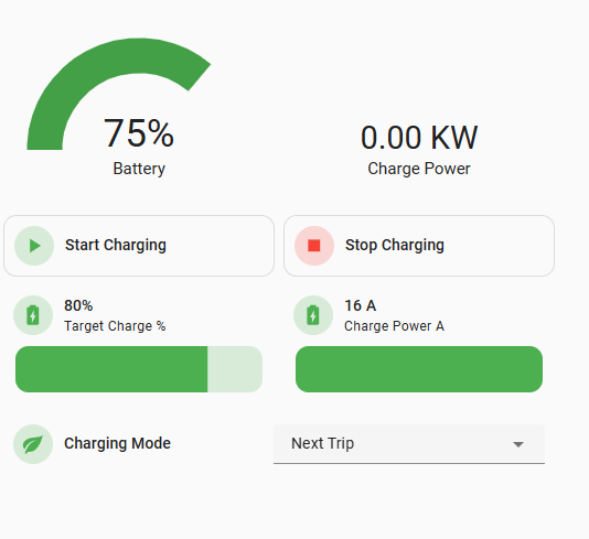

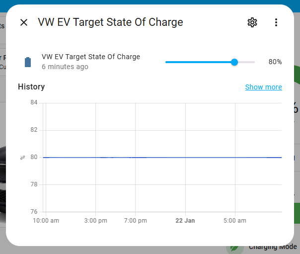

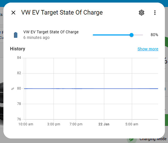

Hi everyone,
I’m wondering if the Target State of Charge parameter can be modified or if it’s a read-only value? I couldn’t find clear information about this in the documentation.
@AnthonyStark It can. I have it set up as a slider.
Thank you, it works. There were probably issues with the connection to my car. There isn’t a way to adjust the charging locations and their associated parameters, or am I mistaken?

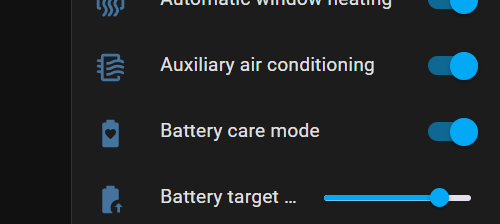

does anybody know what auxiliary air condition is? is it the same as pre-conditioning?
VW ID.7 touring GTX
