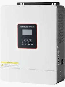

I’d like to share a custom integration for Voltronic-compatible hybrid solar inverters (PI30 protocol: Axpert / MPP Solar / Vevor and similar). I developed it on a Vevor GD5548JMH (reports as VMII-4000, 24 V / 4000 W, firmware 00040.09) and publish it in the hope that it is useful to others, and to find out how it behaves on other models.

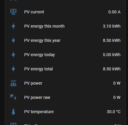

  • PV energy today / month / year / total (kWh) from the inverter’s own counters, usable directly in the Energy dashboard

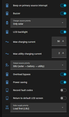

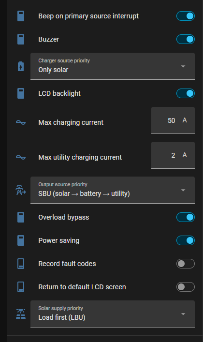

  • Controls: switches for option flags, selects for output / charger priority, numbers for charge currents and voltage thresholds
