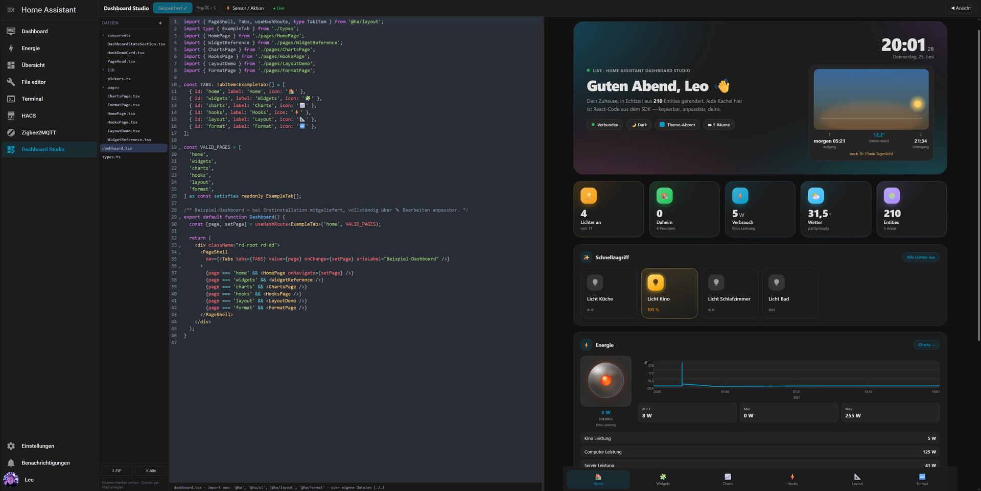

Here's a little preview of the integration
I would really appreciate your thoughts on this.
