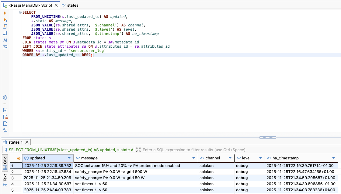

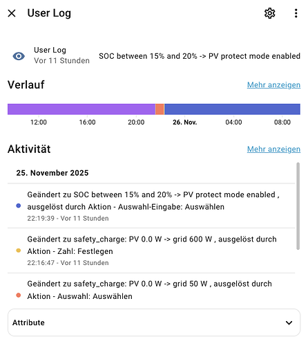

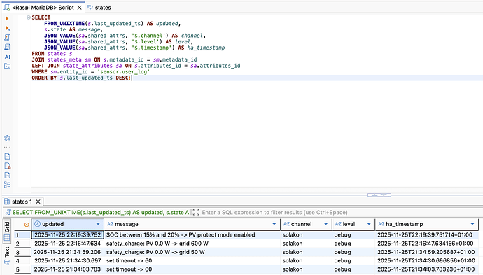

And basically it works:
Unfortunately, it doesn’t work reliably.
I’m working on automation for Solakon One.
Some logs are recorded correctly, others are not, even though the branches are processed correctly.
The project is not yet complete. So far, only the first two modes have been implemented.
The image shows that the switch to PV protect mode was logged, but the log from lines 237 onwards should also have appeared, as the switch from 600 W to 0 also took place.
