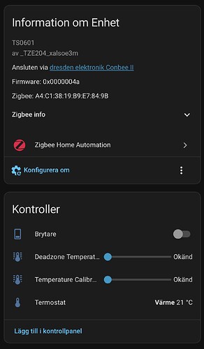

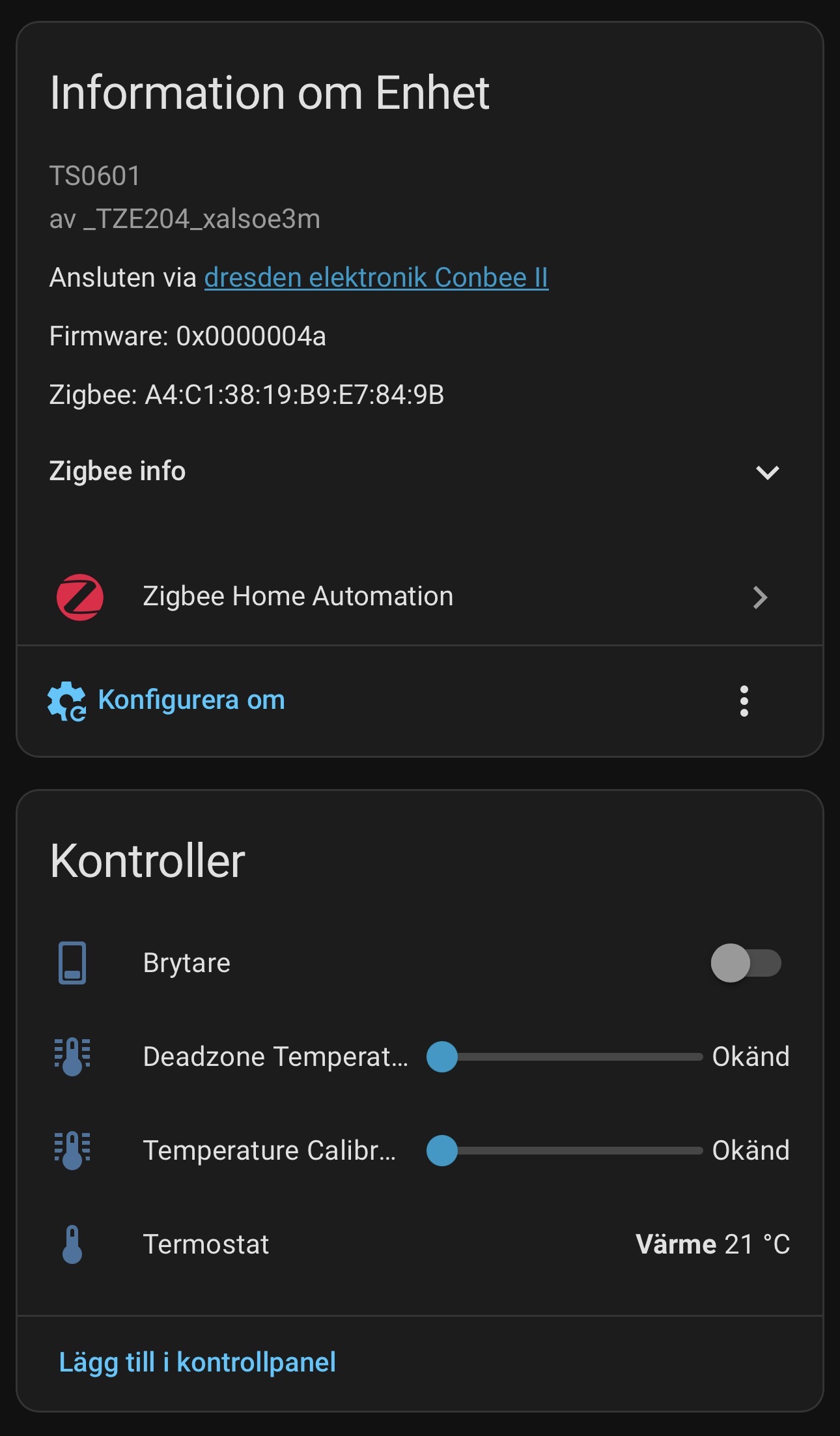

I have this MOES electric floor heat thermostat:
TS0601
_TZE204_xalsoe3m

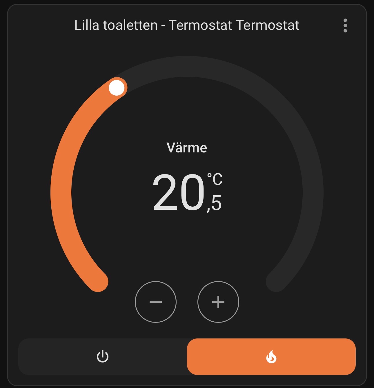

Made a custom quirk that works for me but it need some more tinkering.
I have the same device. Can I have please the Custom Quirk. I’m a newbee :slight_smile:
Hi, I’ve had some luck withthis. see my post on GitHub.
I modified an existing quirk for Avatto TRV.
