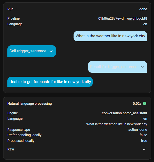

With the automation in it’s current state, here is a debug of the conversation and the traces of the automation.
Debug:
Raw:
stage: done
run:
  pipeline: 01h06a28v7ewdjhwgyghbgcbt8
  language: en
  conversation_id: 01KDV0S86N822KYKEHHYZ9T349
  runner_data:
    stt_binary_handler_id: null
    timeout: 300
events:
  - type: run-start
      language: en
      runner_data:
        timeout: 300
    timestamp: "2025-12-31T20:14:57.756356+00:00"
  - type: intent-start
      engine: conversation.home_assistant
      language: en
      intent_input: What is the weather like in new york city
      device_id: null
      satellite_id: null
      prefer_local_intents: false
    timestamp: "2025-12-31T20:14:57.756383+00:00"
  - type: intent-end
      processed_locally: true
      intent_output:
        response:
          speech:
            plain:
              speech: Unable to get forecasts for like in new york city
              extra_data: null
          card: {}
          language: en
          response_type: action_done
            targets: []
            success: []
            failed: []
        continue_conversation: false
    timestamp: "2025-12-31T20:14:57.771847+00:00"
  - type: run-end
    data: null
    timestamp: "2025-12-31T20:14:57.771861+00:00"
started: 2025-12-31T20:14:57.756Z
intent:
  language: en
  device_id: null
  satellite_id: null
  done: true
  intent_output:
    response:
      speech:
        plain:
          extra_data: null
      card: {}
      language: en
        targets: []
        success: []
        failed: []
finished: 2025-12-31T20:14:57.771Z

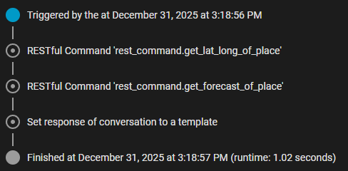

Given that the automation completes successfully, and returns the conversation response, I do not understand why assist returns “Unable to get forecasts for like in new york city” or similar. One hunch I had is that the automation may be taking too long and assist is timing out. From a quick look online, I wasn’t able to find any details to help with that though.

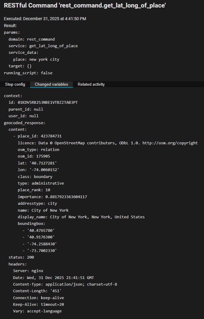

What does the trace show for geocoded_response? Is it correct? Start at the top and work down looking at changed variables and everything to make sure you are getting the responses you expect.

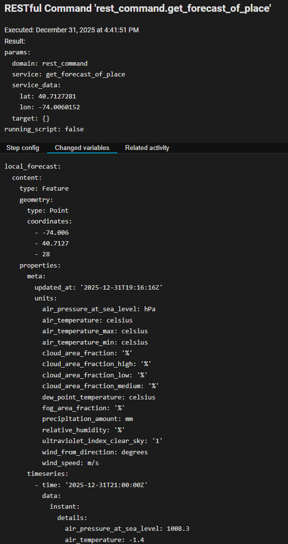

Both API responses work, as far as I can tell. Here are the traces of the two RESTful command calls.
get_lat_long_of_place:
get_forecast_of_place:
The response from this one is too long to put in the body of this post, but it returns as expected.

Here is most of the json but the weather forecast response from met.no is too long to fully post.
  "trace": {
    "last_step": "action/2",

            "geocoded_response": {
              "content": [
                  "place_id": 423784731,
                  "licence": "Data © OpenStreetMap contributors, ODbL 1.0. http://osm.org/copyright",
                  "osm_type": "relation",
                  "osm_id": 175905,
                  "lat": "40.7127281",
                  "lon": "-74.0060152",
                  "class": "boundary",
                  "type": "administrative",
                  "place_rank": 10,
                  "importance": 0.8817923363604117,
                  "addresstype": "city",
                  "name": "City of New York",
                  "display_name": "City of New York, New York, United States",
                  "boundingbox": [
                    "40.4765780",
                    "40.9176300",
                    "-74.2588430",
                    "-73.7002330"
              "status": 200,
              "headers": {
                "Server": "nginx",
                "Date": "Wed, 31 Dec 2025 21:41:51 GMT",
                "Content-Type": "application/json; charset=utf-8",
                "Content-Length": "451",
                "Connection": "keep-alive",
                "Keep-Alive": "timeout=20",
                "Vary": "accept-language"
          "result": {
            "params": {
              "domain": "rest_command",
              "service": "get_lat_long_of_place",
              "service_data": {
                "place": "new york city"
              "target": {}
            "running_script": false

            "local_forecast": {
              "content": {
                "type": "Feature",
                "geometry": {
                  "type": "Point",
                  "coordinates": [
                    -74.006,
                    40.7127,
                    28
                "properties": {
                  "meta": {
                    "updated_at": "2025-12-31T19:16:16Z",
                    "units": {
                      "air_pressure_at_sea_level": "hPa",
                      "air_temperature": "celsius",
                      "air_temperature_max": "celsius",
                      "air_temperature_min": "celsius",
                      "cloud_area_fraction": "%",
                      "cloud_area_fraction_high": "%",
                      "cloud_area_fraction_low": "%",
                      "cloud_area_fraction_medium": "%",
                      "dew_point_temperature": "celsius",
                      "fog_area_fraction": "%",
                      "precipitation_amount": "mm",
                      "relative_humidity": "%",
                      "ultraviolet_index_clear_sky": "1",
                      "wind_from_direction": "degrees",
                      "wind_speed": "m/s"
                  "timeseries": [
                      "time": "2025-12-31T21:00:00Z",
                      "data": {
                        "instant": {
                          "details": {
                            "air_pressure_at_sea_level": 1008.3,
                            "air_temperature": -1.4,
                            "cloud_area_fraction": 9.4,
                            "cloud_area_fraction_high": 4.7,
                            "cloud_area_fraction_low": 0.8,
                            "cloud_area_fraction_medium": 7.8,
                            "dew_point_temperature": -9.6,
                            "fog_area_fraction": 0,
                            "relative_humidity": 53.5,
                            "ultraviolet_index_clear_sky": 0.1,
                            "wind_from_direction": 253.6,
                            "wind_speed": 5.4
                        "next_12_hours": {
                          "summary": {
                            "symbol_code": "partlycloudy_night"
                          "details": {}
                        "next_1_hours": {
                          "summary": {
                            "symbol_code": "clearsky_day"
                          "details": {
                            "precipitation_amount": 0
                        "next_6_hours": {
                          "summary": {
                          "details": {
                            "air_temperature_max": -1.1,
                            "air_temperature_min": -2.3,
 "status": 200,
              "headers": {
                "Server": "nginx/1.18.0 (Ubuntu)",
                "Date": "Wed, 31 Dec 2025 21:41:52 GMT",
                "Content-Type": "application/json",
                "Content-Length": "4396",
                "Last-Modified": "Wed, 31 Dec 2025 21:41:52 GMT",
                "Expires": "Wed, 31 Dec 2025 22:12:46 GMT",
                "X-Backend-Host": "b_157_249_79_114_loc",
                "Access-Control-Allow-Origin": "*",
                "Access-Control-Allow-Methods": "GET",
                "Access-Control-Allow-Headers": "Origin",
                "Content-Encoding": "gzip",
                "Vary": "Accept, Accept-Encoding",
                "X-Varnish": "6086353268",
                "Age": "0",
                "Via": "1.1 dalton-a (Varnish/7.7)",
                "Accept-Ranges": "bytes"
          "result": {
            "params": {
              "service": "get_forecast_of_place",
              "service_data": {
                "lat": 40.7127281,
                "lon": -74.0060152
              "target": {}
      "action/2": [
          "path": "action/2",
          "timestamp": "2025-12-31T21:41:52.235329+00:00",
          "result": {
            "conversation_response": "In new york city it is 29.48°F and clearsky_day. The high is 30.02°F and the low is 27.86°F."

          "action": "rest_command.get_forecast_of_place",
          "metadata": {},
          "data": {
            "lat": "{{geocoded_response['content'][0]['lat']}}",
            "lon": "{{geocoded_response['content'][0]['lon']}}"
          "response_variable": "local_forecast"
          "set_conversation_response": "In {{trigger.slots.place}} it is {{ local_forecast['content']['properties']['timeseries'][0]['data']['instant']['details']['air_temperature']*(9/5)+32 }}°F and {{ local_forecast['content']['properties']['timeseries'][0]['data']['next_1_hours']['summary']['symbol_code'] }}. The high is {{ local_forecast['content']['properties']['timeseries'][0]['data']['next_6_hours']['details']['air_temperature_max']*(9/5)+32 }}°F and the low is {{ local_forecast['content']['properties']['timeseries'][0]['data']['next_6_hours']['details']['air_temperature_min']*(9/5)+32 }}°F."
      "mode": "single"

Thanks for the help everyone! I was able to get some help on the discord. The root cause was that I had another custom sentence automation from a blueprint that was also triggering. That automation was finishing first and returning the failure message.
I was able to debug this by setting a completely unique trigger sentence to test the automation, and then disabling the interfering automation.
