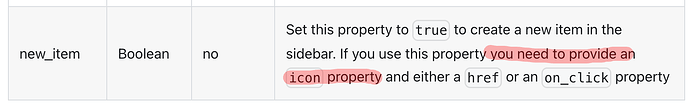

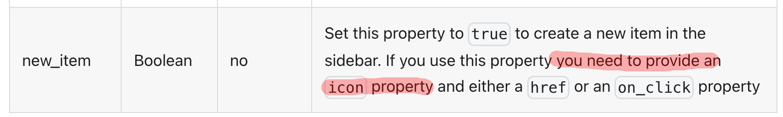

When you fix that, you will receive an error because of what is explained in the new_item option in the documentation.
