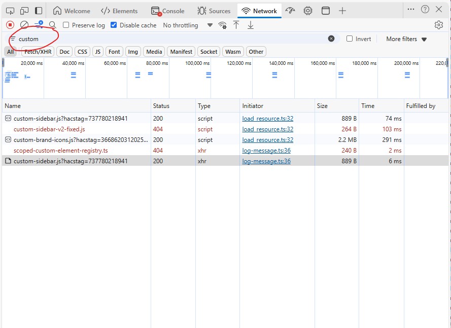

Ok so in developer console of Edge I have this when I filter using “side”
I am not sure why there is a reference to an error for custom-sidebar-v2. I have deleted it from hacs and checked folder deleted automatically from community folder.
I see uncaught error custom-siderbar.js… not sure what that means
thanks
After deleting it from your folder and from the extra_module_url in your config, you need to restart Home Assistant and clean cache.
It means that it doesn’t found /hacsfiles/custom-sidebar/custom-sidebar-yaml.js. So the same, after doing the changes in your config in the extra_module_url, restart Home Assistant and clear cache.

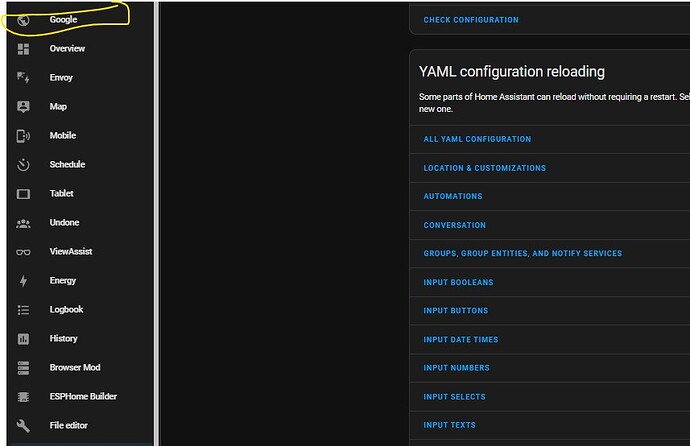

So I tried changing the link in the configuration from
- /hacsfiles/custom-sidebar/custom-sidebar-yaml.js to
- /local/community/custom-sidebar/custom-sidebar-yaml.js
this temporarily shows me the sidebar items I am expecting as I hit refresh frantically as HA is restarting and then it switches to default sidebar items.
So I am trying to figure out two things I guess.
Why is the link “/local/community/custom-sidebar/custom-sidebar-yaml.js” working partially as opposed to the “/hacsfiles/custom-sidebar/custom-sidebar-yaml.js”
Why does it go back to default items?

I followed the instructions you mentioned. That is ‘If you are in a browser, open the developer console, go to Network and check the checkbox labeled as Disable cache, refresh the browser with the developer console open.’
In that same window (the network tab), in the filter field search for custom and check if custom-sidebar-yaml.js is there or what appears in its place.
Also, post the results of the troubleshooting:
  • Does the console info with custom-sidebar version appears?
  • Is there any error?
  • Did you try with a very simple configuration, for example, a title change?

That is what is happening, until you don’t fix the issue that your system keeps trying to load custom-sidebar-v2-fixed.js and not custom-sidebar-yaml.js you cannot make the plugin to work (basically because the system is not loading it). You have a caching issue there, if it is not related to Home Assistant or your browser, then it is related to your provider, your reversed proxy or whatever middle network layer that you have there. Check this for an example, it shows you what kinds of things can provoke issues like that.
Yes, it is logic, Home Assistant is not loading the plugin
The same, the errors show that the system is still trying to load custom-sidebar-v2-fixed.js (and it is not loading custom-sidebar-yaml.js).
The same, until you don’t fix the above issue, it doesn’t matter the troubleshooting steps because the troubleshooting steps are intended for the case that Home Assistant is loading the plugin correctly (and the console info is shown in the developer console). And until you don’t fix a bullet point of the troubleshooting you cannot continue to the next one, first thing is to get the console info of the plugin in your console and to achieve that, the plugin needs to be loaded first.
By the way, as you are using HACS do not use the local path, the local path is intended only for manual installations and it doesn’t have the non-caching functionality of the hacsfiles alias.
The same, ignore anything related to custom-sidebar configuration. Try to fix the issue that you are having and until you don’t see custom-sidebar-yaml.js loaded in your network tab, do not try anything related to the plugin configuration.
I really don’t know what is provoking that in your set up, but until you don’t see custom-sidebar-yaml.js loaded in the network tab instead the custom-sidebar-v2-fixed.js resource do not try to test the plugin because the plugin is not loaded by the system.
