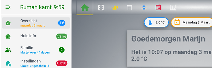

With the fast development of this custom plugin, there is something that has become more obvious:
leaving the instance and getting back to it seems to not cause an auto update of the frontend. This most noticeable in my header template where I have the time…
In the morning it simply shows the last time I opened the app the night before.
Or after posting this… I left for 8 minutes as you can see :wink: :
Also, on 1 of my items, the Energy tab, I have set a notification template. This stalls when leaving, and, after returning there, one can see the complete history of that entity state race in that notification.
It’s a fun effect, but nor really as it should be imho.

In the current 2025.3 beta, Bram has inplmeneted an auto update front-end refresh, but it does not help with this sidebar effect.
Maybe you can have a look why this happens, and if the new feature in the Frontend could be used to also update the sidebar?
I did read this:
https://elchininet.github.io/custom-sidebar/advanced-configuration-options/javascript-variables
more importantly the final Important section.
However, I would expect a header to follow the state of the sensor at all times in this case?
