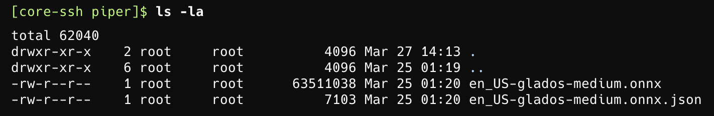

So I uploaded the custom voice files to /share/piper and it’s recognized by Home assistant

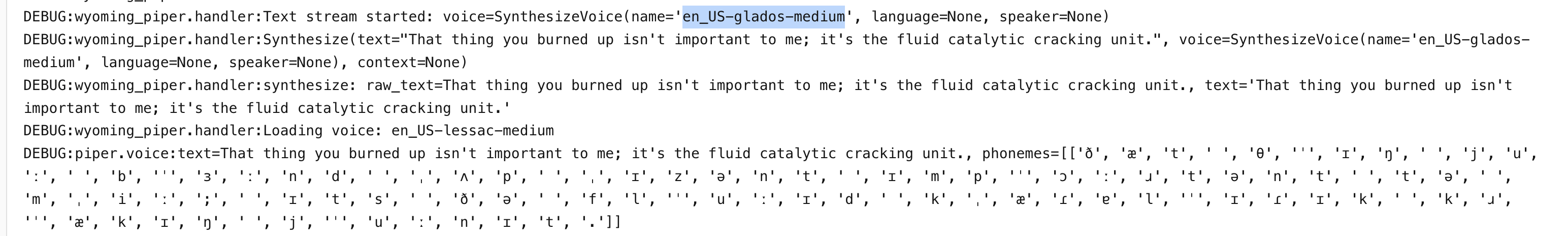

I’m certain the custom voice is working as I can manually call tts.speak service and the GLaDOS voice comes out from the speaker. And the Piper addon log shows that GLaDOS voice is being picked.

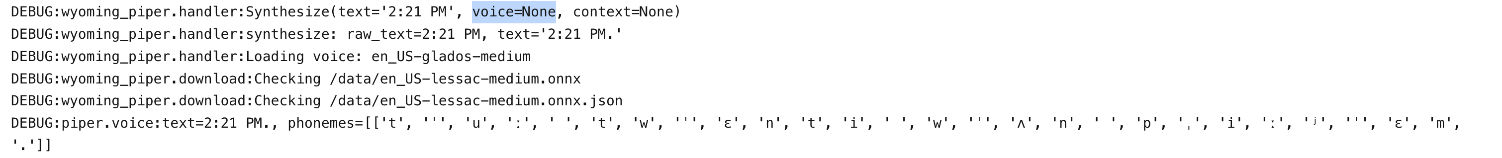

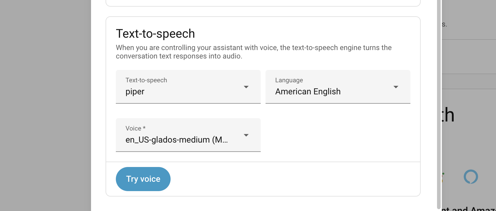

However, when having conversation with the assist, the voice argument is missing in the request, thus the default voice is used to generate voice.
May I ask if it’s a known problem and how to fix that? Thanks!
